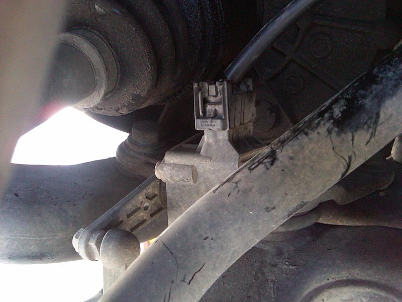

All three dash warning lights came on at once, right after I backed the car up 50 feet or so, then drove off again. DSC, ABS, and tire pressure. Checked pressures, adjusted one tire, pulled, checked and switched main ABS fuse, others related. DSC is definitely not working, haven't hammered the brakes to test them. Otherwise driving fine. Any thoughts on possible problem?
This is the only sensor I can find, on the left front, but it appears to be height related.
Anybody?
Yeah, I'm buying a shop book soon

is almost always a wheel speed sensor. Check to see that the connectors are clean and well seated. Also check to see that the sensor is properly mounted to the steering knuckes and trailing arm. A good diagnostic tool can even tell you which wheel sensor isn't working properly.

Got it. At first I thought it was just the brake pad wear sensor, but there is a tiny unit, about a half inch long, in the front of the left caliper that is either that, an ABS sensor or the speed sensor; nothing on the right side. When I popped it out, several chunks of if fell out. That makes sense, since the lights came on after the backing up, must have been weak, and the extra strain caused it to fail. I cleaned it up with a file, and there was enough to get it to stay in, and voila, lights out.
I will be on the lookout for a replacement, since the condition it was in suggests it might be prone to fail again, but at least I'll know what's up.
Thanks again for the help.

Wheel speed sensor is the black wire going into the top of the steering knuckle behind the brake rotor. Other end of this wire has a plastic barrel connector behind the plastic wheel well. Remove the sensor, wipe of the crud, and reinstall. Unplug the plug, clean, add a bit of dielectric grease, and re-connect.
