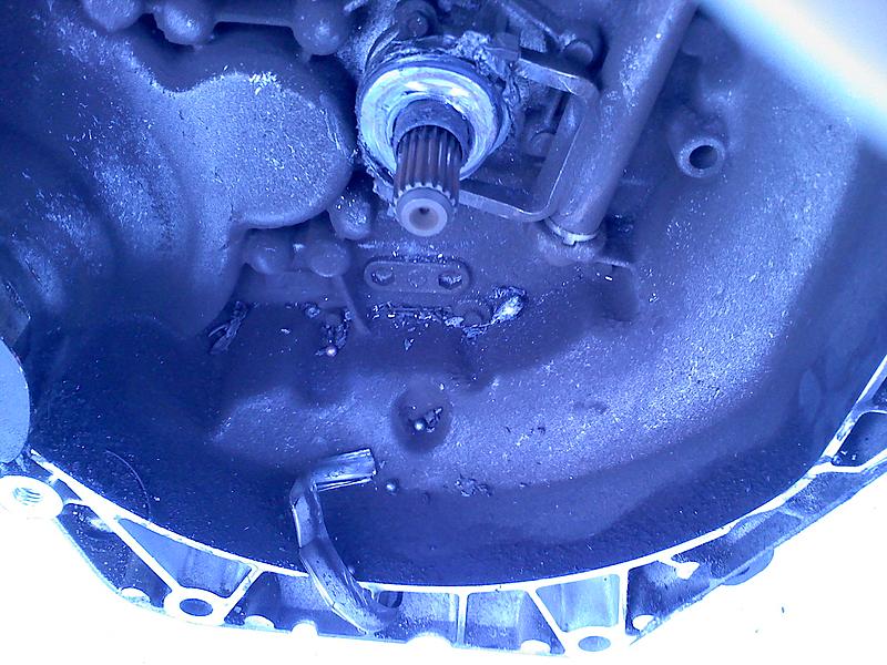

here's apic of my destroyed bearing before i took it out of the trans:

I had a similar issue before my throw out bearing went out and I had to do a clutch replacement at the same time that it happened. When my bearing went it the band on the outside of the bearing had separated sending ball bearings flying and had fused to the guide tube due to heat. Since replacing the clutch, guide tube, and throw out bearing I haven’t heard this noise. Granted this was on a r53.
