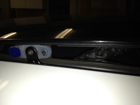

I found the rattle
I have found what is rattling on my car. I originally thought it was the small arms that flip up near the back of the window. These arms come up with the sunroof is just tilted up but retract if you open it all the way. I did all kinds of things to them thinking that they were rattling. Nothing worked.
This week I turned my attention to the more permanent arm that is right on the outside edge of the sunroof. It was there all along but I thought it was fixed and could not move. These arms are about 3/4 of the way down the side of the window, right on the outside edge of the window. I put a little circle of felt tape on the front edge of this arm and the rattle is gone.
Here's a picture. You can see the arm that was rattling on the left. It's got the blue felt on it. The other arm that is not the source of my rattle is on the right.

Thank you tallweed! I put a couple of fuzzy side velcro dots on the spot you show in your photo and the noisy sunroof is once again quiet!
Thank you, thank you, thank you!
I had been chasing this noisy sunroof for about 6 months. Quite an improvement over the near constant rattle just above my head.
