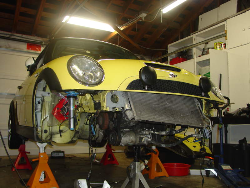

On my car, I just removed the steering knuckle from the bottom of the shock and the outer control arm ball joint. My brakes were disconnected as I was upgrading to Brembos.
nice. that's about where i'm at now:
pics a little, blue, but it's pretty good for coming from a cell phone..

seems odd, though, that it's really just the lower suspension arm that's holding the drive axle in place in the transmission (on the driver's side anyway, since the passenger side's got that carrier bearing).. doesn't it? sounds like if you banged up that lower ball joint on the spindle good you might have to worry about the axle slipping out of the transmission..
Thanks for your help so far, rsvp. you've really cleared up the last of the nagging questions i think i'm going to have..
I guess I'm not following you. On all FWD cars, there is a snap washer on the end of the drive shaft that prevents the axle from coming out. Also, the axle is held in place by the carrier hub/bearing.
snap washer... like part #8 in the pic in the link i posted above, right? so, in the pic you posted of the axle @ the pass. side trans... where you've got your screwdriver in there... there's a "snap washer" in there? on both sides, then. that i have to remove BEFORE the axle will slide out. one of those ones i can just push off with a screwdriver? or do i need one of those ring pliers with the little points on the end of it?
