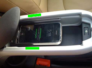

Second, and this isn't specific to Sidewalk Editions, but the armrest lid won't stay shut. Outside of buying an expensive aftermarket replacement, has anyone found an easy trick to get it to snap shut and stay shut?
Thanks Everyone.
- John
Could be a poorly fit lid....Still under warranty - I would ask the dealer to look/replace it.

I'll bring that up when I take it in for the next service. Good idea. I've heard that this is a common problem with this particular arm rest, so maybe Mini will have some in stock or will have a fix for it.

My armrest was constantly sliding open, so I attached some hook-&-loop tape to the lid.
I put the soft loop side on one of the rails that the lid slides over & attached the hook side to the lid.
When the armrest is closed, you can't see the tape & the lid stays shut. It also slides open with no problems.
I hope that helps.

Good info, Not4no1. I'll give that a try if they won't fix this under warranty. However, I'm not really getting a good mental picture of what you're actually doing. Do you happen to have some pics of what you did to fix it?

I found a pic of the armrest online & put green stripes where I have my loop tape. The hook side of the tape can't be seen in this picture because the lid is open.
I hope that makes more sence.

Yeah, I'm thinking this won't work on my armrest because the lid doesn't tilt up, it only slides back and forth on the rails, so I don't know how I would get the tape to the top section of the armest lid.
Thanks anyway for the suggestion. Maybe I'm mistaken...I'll give it another look this evening.

I have had two armrests now, both OEM, supplied under warranty and both slide open, it's your arm, the connection is not great.

I just had mine replaced under warranty. I was told it's common problem.
