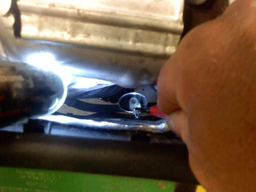

I have an 07 MCS with a very bad oil leak. The leak is comming from behind or to the driver side / behind the turbo. From underneath I can see the drip (right on my exhaust pipe) but can't see the source.
If I go between the grill and the motor to the driver side of the turbo with an inspection mirror pointed upwards I can see what appears to be a circular flange of some sort with what might be bolts in it but I can only position the mirror to see 1 nut.
Anyone know what this is.
I'll attach a picture....but you have to look into the mirror to see it....
Again this is to the driver side of the turbo....lined up with the first spark plug on the driver side.
In the picture...the silver area to the top is the turbo shield, the black strip is the grill...
Anyone have any pictures oif this motor out? That might help me
Bobby

I can't ID what's in the mirror, but the oil filter housing sits very near that area you described (under the radiator overflow container). Has anyone changed the oil filter recently and the leak show up after that? Cracked filter housing? It's plastic, and will crack if overtorqued. Just my $0.02 worth

Yes.... it's very close to the filter housing...but it doesn't seem to be the filter housing. It's a few inches to the passenger side of the motor. A mechanic tryed to tell me it was the rear seal, but no way...there's no oil coming out of the bell housing hole.
There's something else in that area, but it's very hard to see.... a picture of the motor would probally tell me
Thanks for your reply

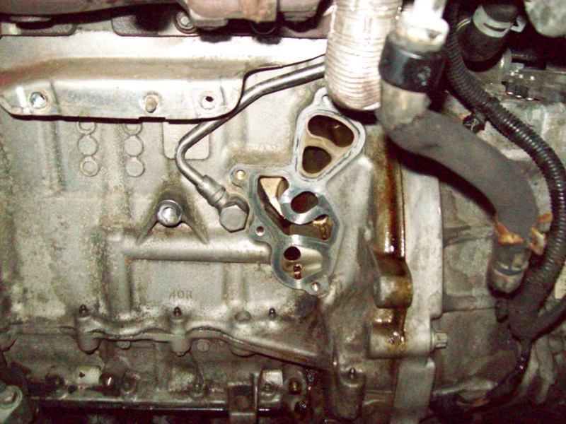

Here we go guys,
We dug into this today....
It was the heat exchanger gasket that was leaking...
The gasket inlay was flat and flush or below the gasket groove...I supose the heat got to it.
And this is what you have to do to get at it.
The dealer...mechanic from prestige who told me it was a rear seal was fill of it....I hope he's here reading this.
Bobby

Wow - great photos. Thanks!
How long did it take to remove all the front end parts? Do you have access to a shop manual - and if it covers the '07, where can I find one?

No surprise on the MINI tech being FOS. As for a shop manual there is ONLY a software version nothing on paper. You can purchase a DVD copy on Febay or send me a pm and I'll send you to where you can obtain a free copy.

started at 2:00 and got everything off and cleaned up by 7:00....5 hours.
thanks for the offer of the manual.....but i'm done with mini's.
bobby
