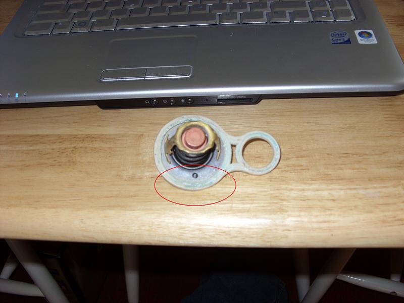

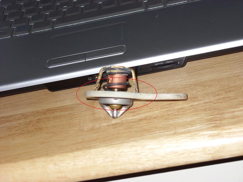

I replace the thermostat and gasket and that's what the problem was. When I pulled the old one out you could see the gasket was deformed and was causing the leak. I didn't replace the plastic housing piece because from what I saw on the forums was that they didn't have problems (or not nearly as many) with the housing from 2005 and up. I could be wrong though, but either way it's not leaking anymore! It was pretty easy too. A little time consuming because you gotta move the air box out of the way in order to get access to the thermostat housing, or at least to make it a lot easier to work on and I have never really worked on my MINI before (I'm use to OBD 0/1 Hondas). I forgot my camera when I was going to work on it so I don't have a step-by-step guide to put up but if anyone is in north east part of Massachusetts (Lowell/Lawrence/Andover/etc...) or south east part of New Hampshire (Nashua/Salem/etc...) and plan to do this, I'll be more than happy to come help. Just let me know!
Here is the pic of the old thermostat w/gasket:
Notice how it's deformed on the side and it's wavey which caused the leak?
And you can see the residue in this picture from the leak itself...
