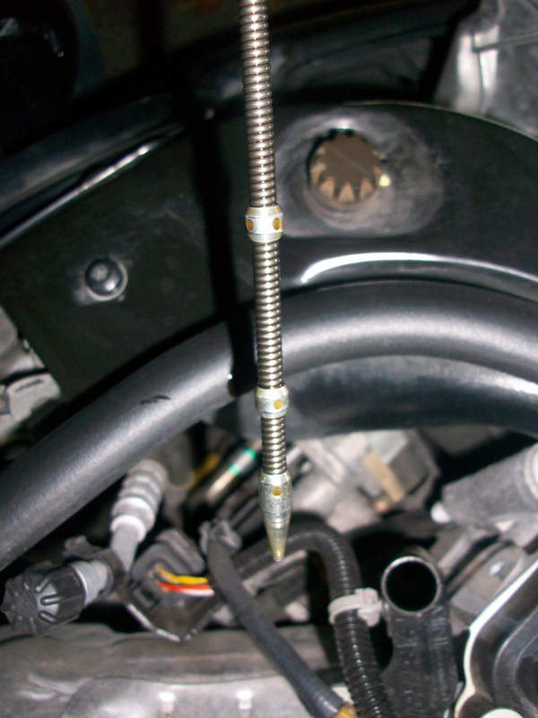

They've changed the dipstick since yours was built. There are no longer any metal *****...now it's orange plastic shaped somewhat like a bowling pin. The color was cleverly chosen to make any oil on the dipstick invisible.

anyways i checked the oil today.
drove for like 20 mins, stoped and waited around 12 mins then i checked it. but im not sure of HOW to read it, i mean i know how to read other dipsticks but i dont understand the cooper one.
can anyone help and "read" this dipstick for me?
I'm pretty sure the top ferrule is "full", the middle ferrule is "one quart low", and the bottom pointed ferrule is just to guide the dipstick through the tube.
If you're having a hard time actually telling where the oil level is on the dipstick, the standard method is to lay the dipstick on a paper towel. The oil will transfer to the towel, and it will be easier to see that way.
