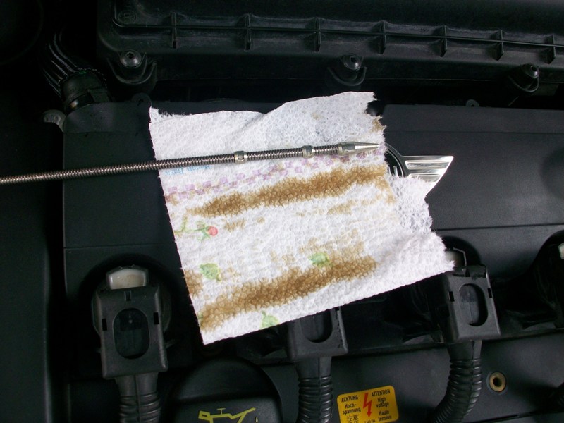

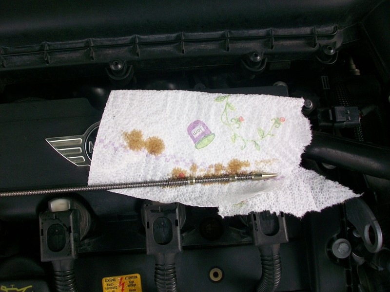

ok........ so i was gona check the oil today.
after driving i parked the car, and was gona wait the 15 mins, but time flies so i ended up checking after 30 mins, the hood scoop wasnt untouchably hot like always, but the dipstick was kinda hot.
here are the pics, i think it may be overfilled....

My '08 MINI (week 12 build) dipstick looks exactly like Topmini's.
Assuming dipstick was wiped clean before measure (in the top photo),
middle photo does look like one liter too much on that paper towel.
I prefer to use a folded scrap of paper to determine exact measure, paper towel will absorb oil and level can creep above true measure.
Normal Oil Level should be kept between the top two ferrules seen on lower photo.
That would be three and a half to four and one-half, never more, never less; (I want mine always between four and four and a half ).
