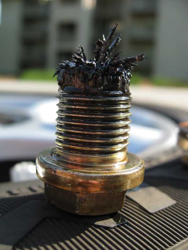

Well, did it today. Busted my knuckles up a bit trying to break the bolts loose, but it's done. As soon as I pulled the drain plug I thought "great, I just wasted time and money on this" as I watched oil drain out that looked clear enough to be fresh off the assembly line (my car has 36k miles on it).
I also saw this (I realize one's missing a washer - it got caught in the oil catch pan but don't worry; it's on now):
I don't recall which was which now, but I cleaned the sludge-ish stuff off them, replaced the drain plug, and refilled the transmission. Not too bad; the worst part of today (transmission and oil change) was fighting with the oil filter to get the new one on.

wow,the dealer is a stealer. thats the G rated version.good going on fluid change! cool photo of sludgey plug

So are the shavings attached to the magnet plug something to be concerned about or just normal wear and tear?
