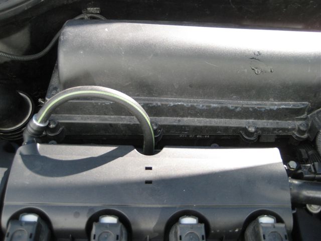

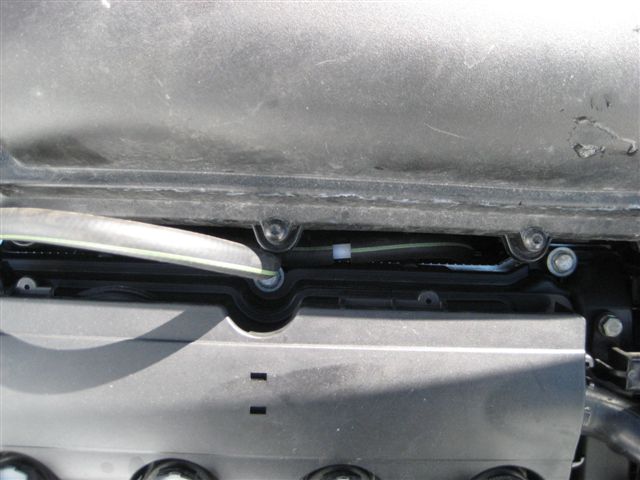

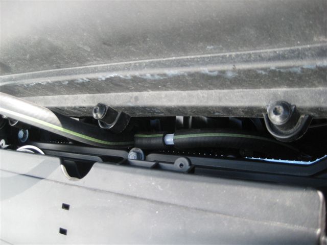

So far so good
I have the car back. It has been out of service for 9 weeks.
The new manifold is installed, as well as a new valve cover. The only visible difference I could see is the hose system. It is cold and sunny in Winnipeg, so the pics are a bit washed out. I shall try to attach them.
I am thoroughly impressed with the service I received - the car was immaculate, and all service was brought up to date (change brake fluid etc).
It runs well - I think is sounds a bit different, but it has been a while so I am not certain.
Hope the engine keeps running - it is nice to be driving a Mini again.

Those hoses are weird, I saw your photos and ran out to my car to see. I don't have those and I don't know where your hoses are going. What got replaced on mine was Intake manifold (#11617570041 and #13712753078). I got those #'s off realoem. There were on part #'s on my receipt, but I can clearly tell whats new in my engine bay.
Scott.
Old Feb 27, 2009 | 05:41 PM
  #272
BlackinBlue's Avatar
BlackinBlue
Joined: Aug 2008
Posts: 27
From: Winnipeg, Manitoba
The hose comes off the valve cover (the big arch), and then splits into four (horizontally) - each being fed into the individual intakes.
Looks a bit like a radiant heating manifold for in-floor heating.
