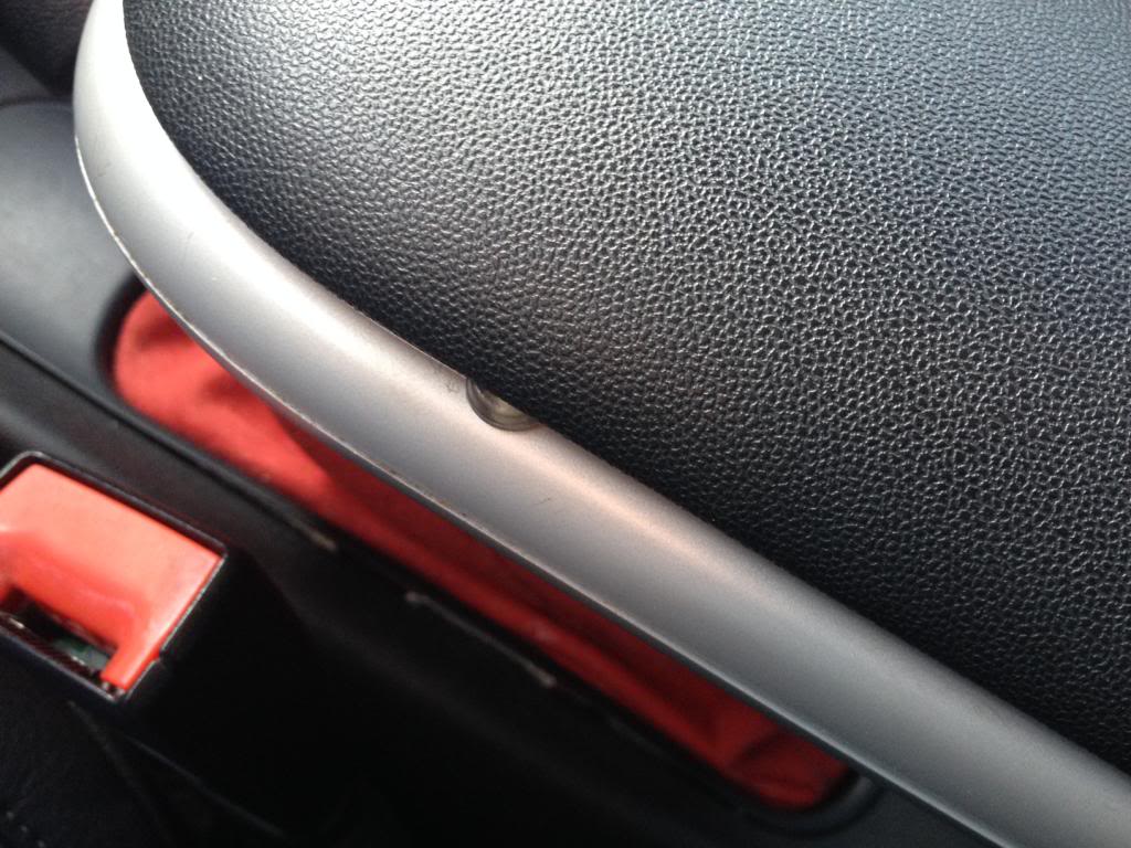

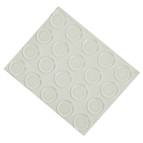

I know this is an old thread, but here is how I "fixed" mine on the cheap. You can buy
these these
types of bumpers at Lowe's, Home Depot...etc.
I just stuck one on each side of the armrest frame, and they stay there for a few months until they finally give up the ghost and fall off. If you pull up slightly as you close the cover, they actually do last for a while. Since you buy a whole sheet of them, you always have more.
Here is how they look installed. You can see they are a bit misaligned, as they have been on there for six months or so and are starting to become unstuck, so it's time to replace them. I've never had the lid slide back since installed, and you don't have to reach back to turn a wing nut. Just remember to keep upward pressure on the lid when you close it.
