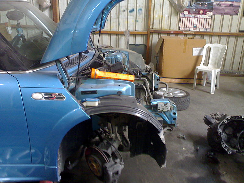

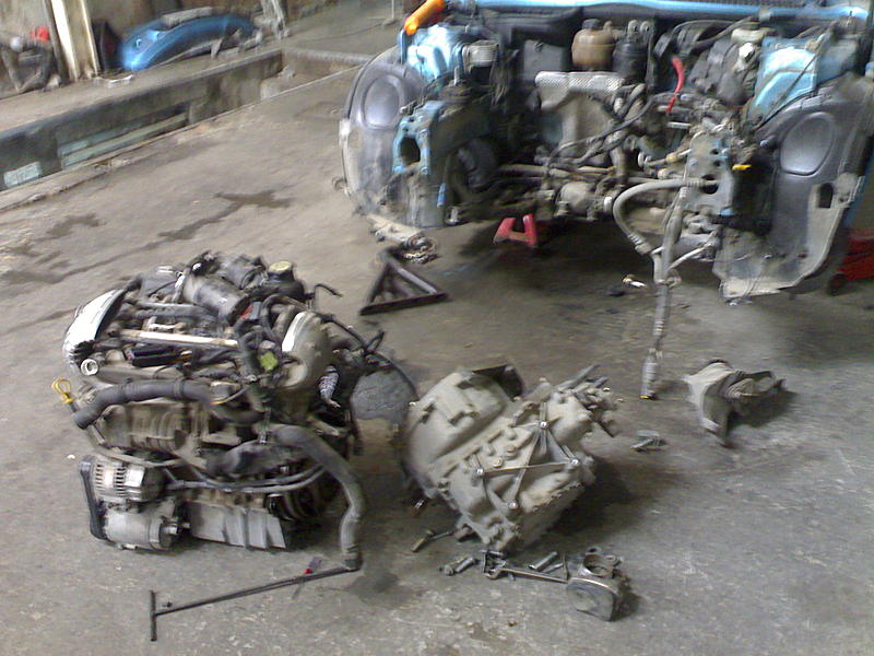

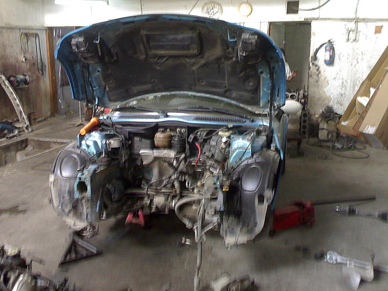

Hi guyz.. why the minis done like that ?
if u gonna change ur clutch Kit, you have to pull the engine totaly out from the car ????????
I dunno how much they will charge me

The child of German and English engineering! No offense to German and English people, just their engineers.

You have got to be kidding me!
Is this for real, do you really need to disassemble the Mini that far to replace the clutch?

No, it can be done with the engine in the car, the tranny does need to come out but the entire engine/transmission assembly does not need to be removed.

That looks like someone is doing more than a clutch. Either that or more work than they have to to do a clutch.

I will do it in 3 hours. Do not know why you remove the whole front end though. I leave the bumper on.

:S I dunno why he did this.

Are these pix for real ???
This looks horrible. The place looks like someone's basement, messy and the engine is sitting on the floor
