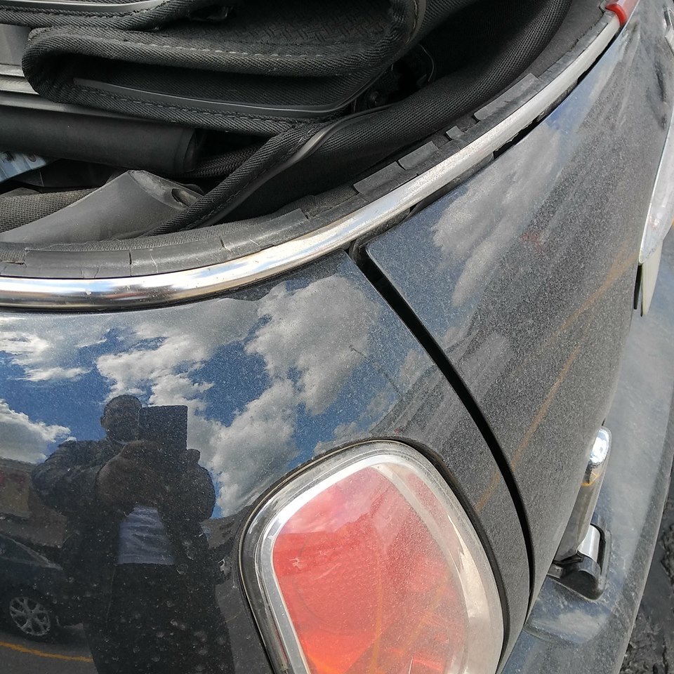

I recently had my R52 in for corrosion warranty work. Drivers side rear quarter as well as the taigate was done. Now, the tailgate is out of alignment. Sent the dealer an email with an image (attached). Here's his reply:
"I have noticed this issue on many convertible models. It has something to do with convertible top and/or seals fitted to the top. You will probably notice if you raise the rear part of the top and close the gate it should fit much better. Once you put the top back down it will have enough pressure to keep the gate from sitting flush.
All the cars I have noticed this on all seem to be on the drivers side for some reason.
We have tried in the past to realign the top, but this seems to make other issues with alignment of parts and possible top function.
Sorry I do not have an exact remedy for this situation."
Thoughts? SHould I take it back and demand an alignment or fix of some sort?
I had mine done on my convertible for rust also and it was aligned. So the rear qtr panel is too high on the shoulder?
The quarter seems fine, it's the tailgate. It's flush with the quarter on the passenger side, but it's popping out at the top ever so slightly on the drivers side. It's not huge, but it's setting off my OCD. And, despite the dealer's suggestion, I could have sworn it wash flush when I picked it up.

Update - saw the dealer about this yesterday. Seems the issue is the seal has become so stiff that it's not compressing when the boot is closed. Lifting the base of the top fixes the problem! So, I will be planning to replace the seal when I replace the molding that is rotting away.
