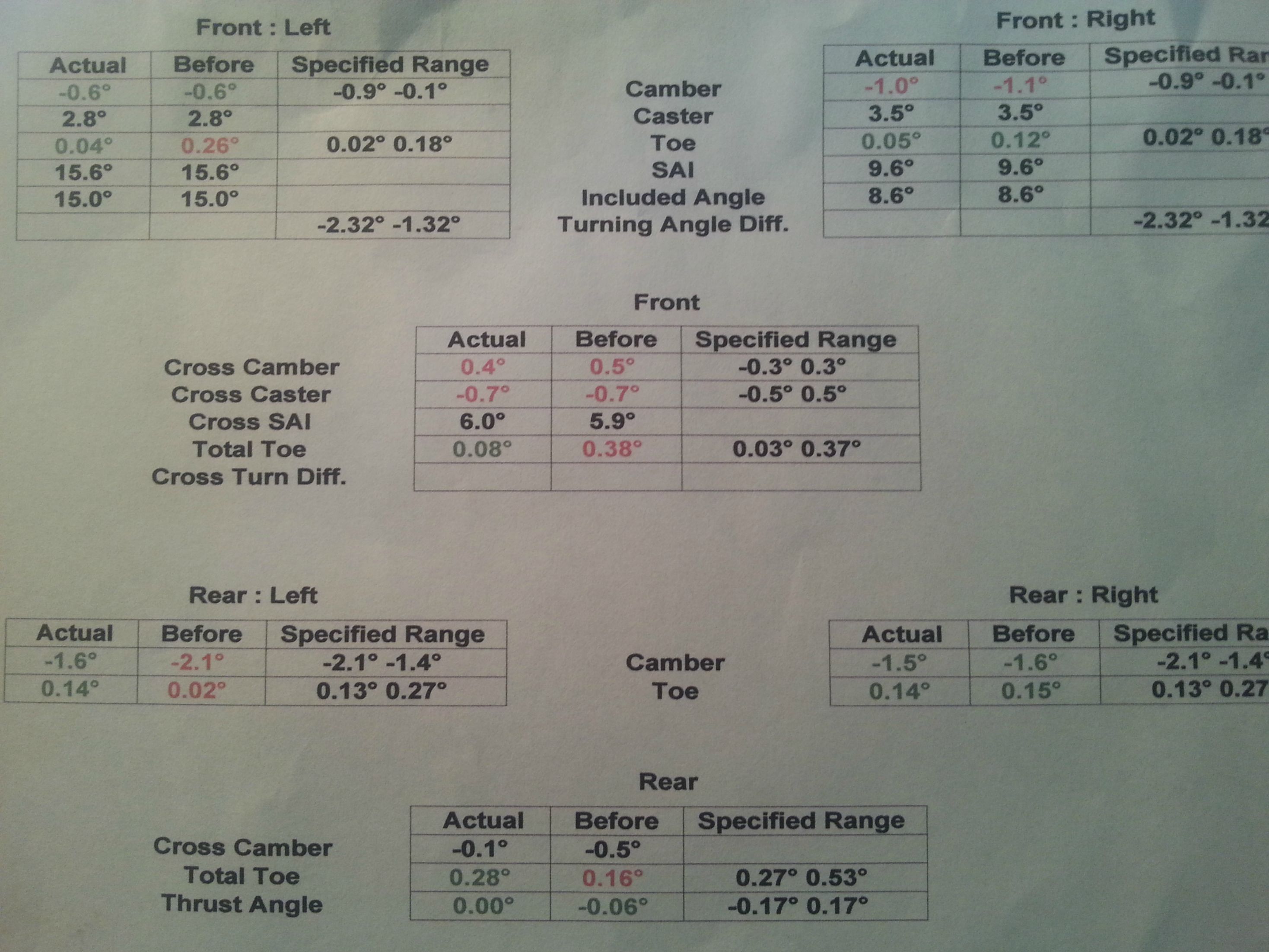

So I'm in better shape for this next event then I have been.
Got my Rear Sway in and got an alignment. I'm excited to see if it feels any different.
Here's my alignment sheet if anyone wants to critique. I told them to 0 the front toe out. Leave whatever negative camber I was able to get with the free camber mod and set the rears to -1.5 camber with factory toe settings.

that's a lot of toe in in the rear

I told them to use factory settings for rear toe. I saw so much different information, and it all contradicted each other. I wasn't sure what to do.

ah you'll be fine

The left and right camber on the front end are rather different, I would not do that because of the variation in turn in that results. Am I reading this wrong, or is the left a .6 and the right at 1.0?

There isn't an actual adjustment on the front. You have to mess with the strut tower and hope for the best.
I don't trust alignment machines too much though. It seems like most of the readings were already skewed towards that side of the car. I'm sure if I took it to a different shop they'd get entirely different readings.
I have an event next weekend so I'll see if she feels any better.

Oh man. What a difference the rear sway and alignment made.
Got 16th out of 85 on PAX. Of course missing some heavy hitters but I'm pretty proud. Picked up almost a full second on my last run of the day.
Turns so much better. I found out on my 2nd run it turns a little too much if I'm not careful.

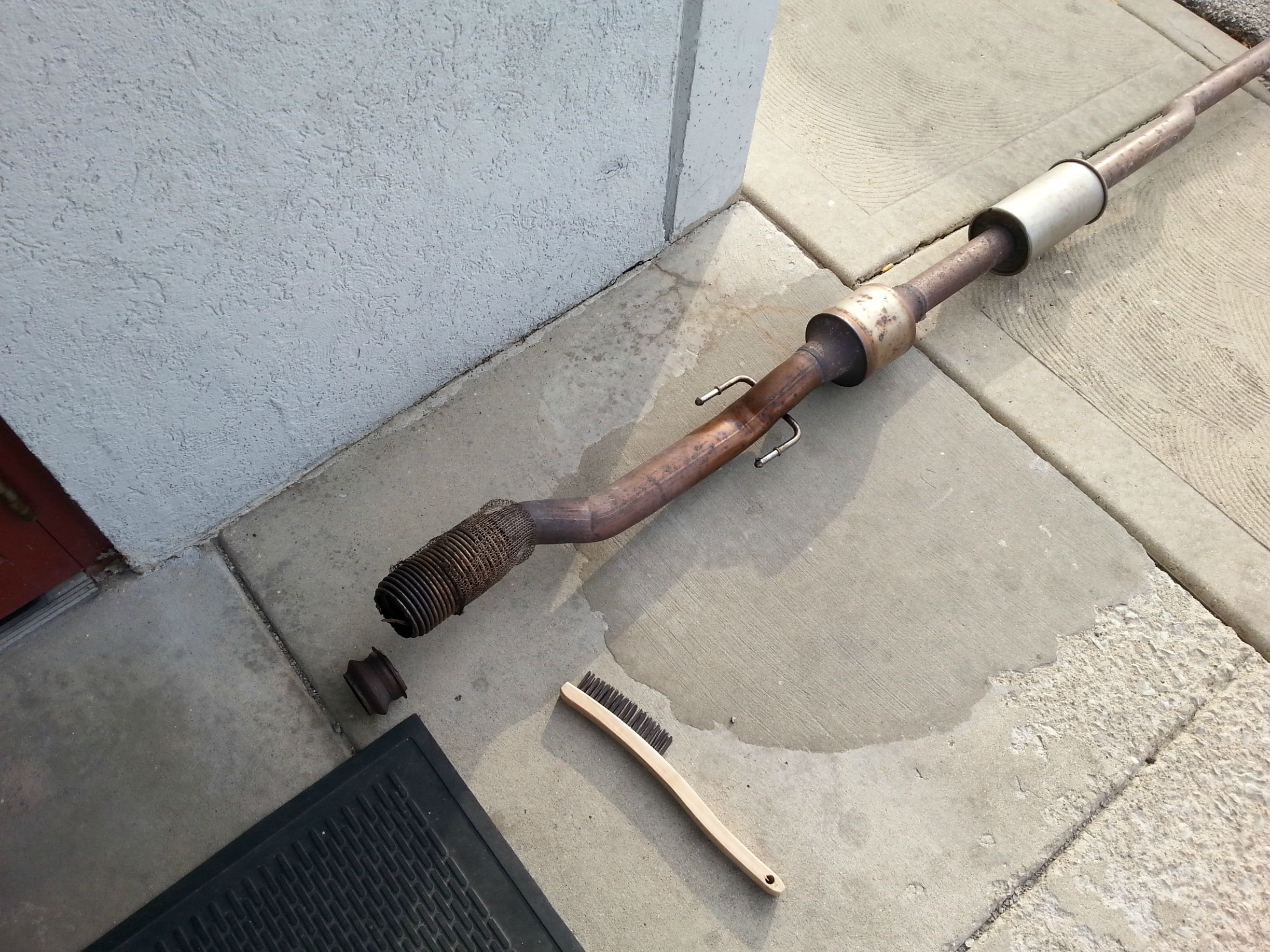

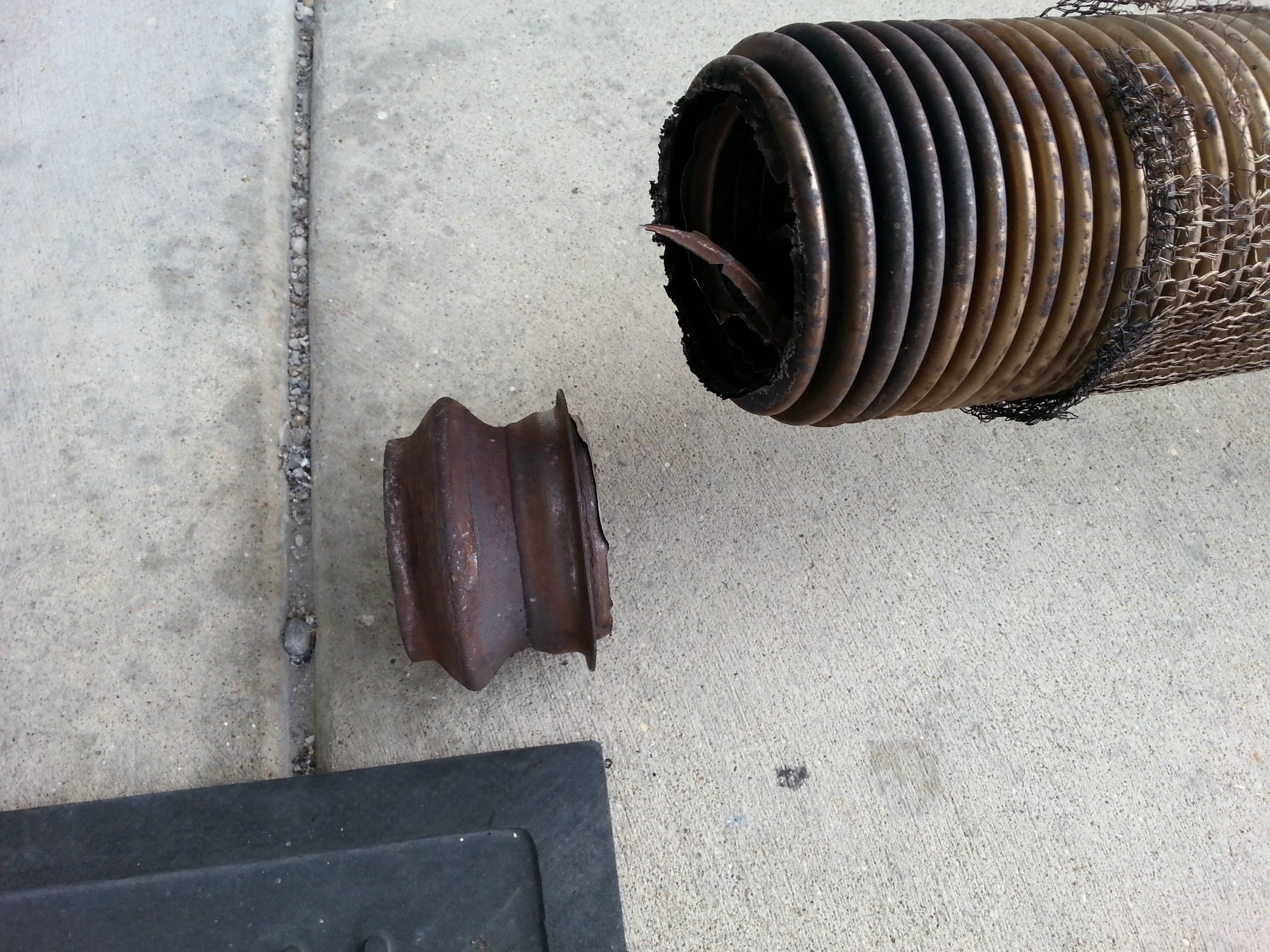

So this happened before the double with TSSCC I was going to attend this weekend.
