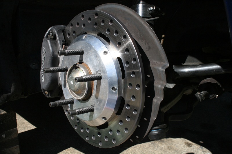

Originally Posted by TazMinianDevil
If you want to get really crazy, smaller brakes so you can run wide and light 15s. That can drop 10-15lbs per wheel upfront. Racing seat, lithium battery will drop 50lbs. That can do huge things for you.
Can't run smaller brakes in STX. Rotors have to be same or larger in thickness and diameter. Seats and batteries are legal as long as the whole seat setup (seat+brackets) weighs more than 25lbs.

Originally Posted by v10climber
Can't run smaller brakes in STX. Rotors have to be same or larger in thickness and diameter. Seats and batteries are legal as long as the whole seat setup (seat+brackets) weighs more than 25lbs. Sent from my DROID RAZR HD using NAMotoring
Wouldn't a rotor kit sized to the base Mini be allowed? If not that, you could do an S sized kit(given it matched dims) that would still drop weight.
Only if you were driving a base mini but those aren't STX legal.
Don't get me wrong there is definitely weight to be saved over the stock mini setup. The problem is that many of the brake setups I've looked at that are significantly lighter than stock require grinding of the ball joint mount which I don't think is legal. I've been talking with Todd at TCE about getting some custom rotors done for the JCW Brembo calipers. Custom 2-piece rotors aren't cheap but theyr'e cheaper than designing a new legal brake setup from scratch. The JCW Brembo calipers are aluminum but I don't know what the weight of a caliper is.
I'm just glad I don't have to spend time/money to develop something like this setup from a SM BMW...

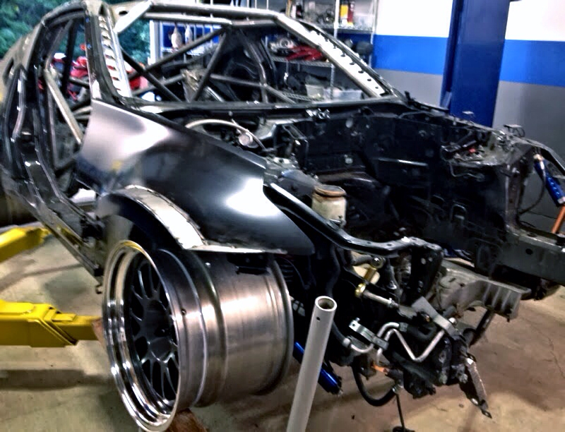

Just to give you a sense of what I'm capable of doing. Here is my 370z hillclimb and track car that I'm currently building with a friend. I'm probably not going to go this crazy with mini build but I have made custom floating aluminum hat rotors with brembo motorsports calipers and have also had 3d printed custom parts developed for 450 hp custom made stoker motor running standalone ECU. Making all my own fiberglass body panels as wel. So I'm willing to do some crazy things eventually. I just want to keep this Mini fairly sane for my daily 80 mile commute over mountain back roads into Silicon Valley.
Attached Thumbnails STX power mods for 2013 S-image-2442511324.jpg   STX power mods for 2013 S-image-2662790014.jpg
