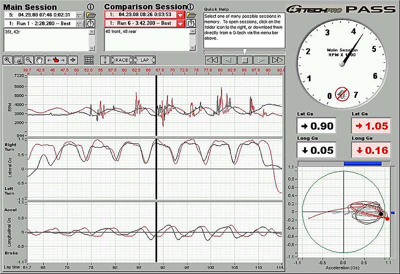

Finding the Wet Z1 Happy Place
I enclose my recent attempt at determining the optimum wet tire pressures for my car, running the Star Spec Z1 195/55-15.
Best grip I've ever had on wet pavement - hands down.
YMMV.
