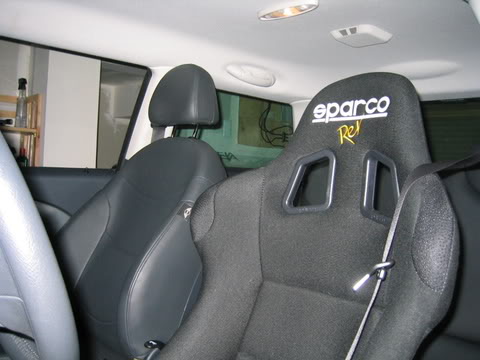

i forgot the name of them, but my friend has a similar one on his old mini racer.. i think it is thompson seats
as for racing seats... i have the sparco rev on the driver side only (about 17 lbs), check sparco's website for size fitment too... someone like me with a 30' waist will fit best in a small seat like the rev, but i guess larger size mini drivers will have a very tough time getting in mine (even i have trouble getting in and out, especially with a thick jacket on)
