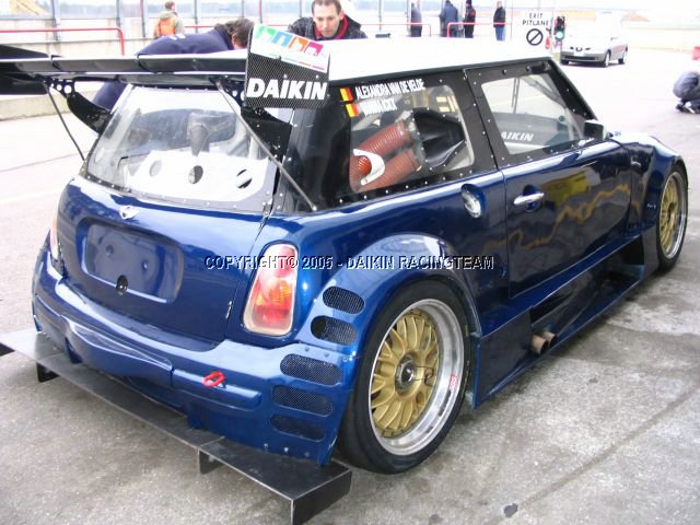

Originally Posted by onasled
As far as I know there are none, but maybe someone will surprise me ..
Surprise!
We have all seen it, But did we really look? Someone did a lot of aero work.
Attached Thumbnails Down force/airflow management-zolder-2003-04-27-071.jpg
Old Dec 16, 2005 | 06:16 AM
onasled's Avatar
onasled
Joined: Sep 2004
Posts: 3,799
From: Northeast CT
Originally Posted by MOTORN
Surprise!
I've studied that car quite extencivly and have a file of photos.
I'm talking with the body builder now in hopes to get the frairs. Body panels are available, but that Mini is longer then stock and they will not fit. I'm sure that with some easy mods it would work.But that's a rear wheel drive car and I don't think we need such a wide body on our FWD cars.
Attached Thumbnails Down force/airflow management-mini-20cooper-20s3-2008.jpg
Old Dec 16, 2005 | 06:44 AM
MOTORN's Avatar
MOTORN
Joined: Apr 2002
Posts: 444
From: wherever
Cool!
Yes, I was refering to the similar aerodynamics. Wing, spoiler, diffuser etc. Since the research had been done, thought it might be easier not to re-invent the wheel.
