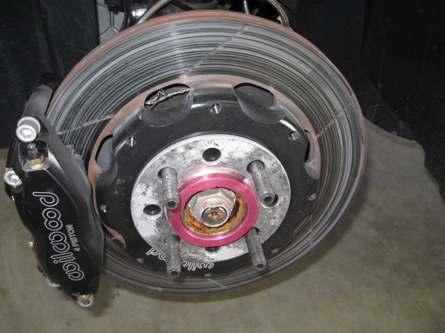

Do your brakes look like this after your sessions??
Then yeah - you have crummy pads. That happened to me at the end of my second session at the Glen, at my very first track day in '08. I went over to a full race pad after that - Hawk DTC70's up front, and stockers out back. Never had a problem again. Oh yeah, I use Super Blue fluid...
they certainly looked similar! Especially im seeing some buildup in the slots which is exactly what happened to me
Similar here: DTC-70's up front in Outlaw 2000 calipers, HP+ in the rear.
Two or Three track weekends from the DTC-70's. The HP+ in the rear last 10 to 12 track weekends.
Yeah, I have HP+'s as we'll but went back to stock. Both work well...
