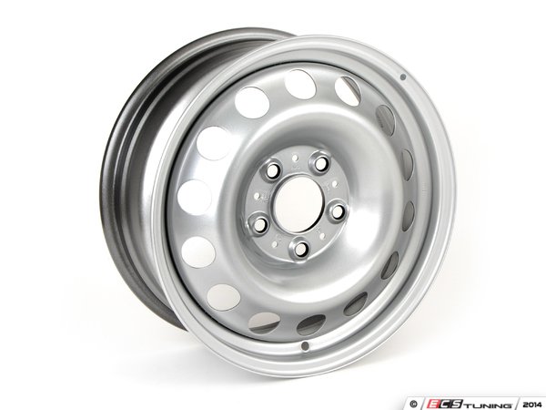

Or get one of the steel wheels and mount a all season tire on it. You would have to strap it down in the trunk. Dont think it would fit under the flat load floor.
16 x 6.5 , Et46, 5x120 bolt pattern. Also know as steelies. 36109803650
http://www.ecstuning.com/Search/SiteSearch/36109803650/
