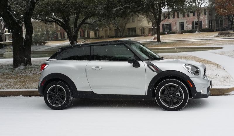

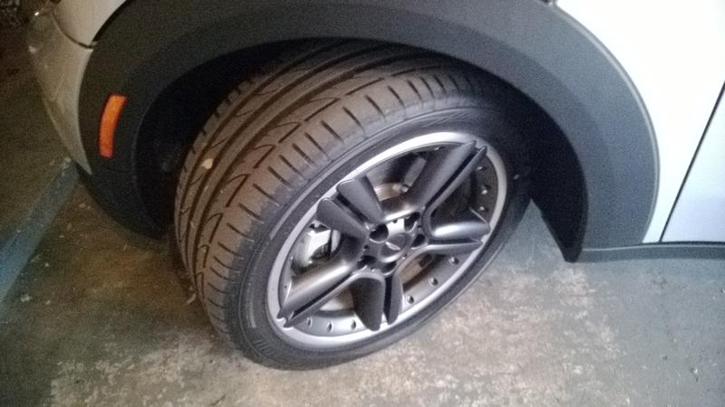

I have stock rims with no spacers or clearance issues on my 2013 Paceman S fwd running the Bridgestone Potenza S-04 Pole Position in 245 45 18. We rarely get snow but they performed better than I expected from a maximum Performance Summer tire. (see photo below)
I do know that actual tire size differs between brands and models, link to tires, click on specs tab to see the numbers.
http://www.tirerack.com/tires/tires....omCompare1=yes
Attached Thumbnails Thickest tire possible-paceman.jpg   Thickest tire possible-wp_20140121_14_44_47_smart-1-.jpg

mine is an all4 with sport suspension ... wonder what is different? the shock strut itself or the hub to strut distance or maybe the hub itself? ... there is no way a 245/45R18 will fit my CM with stock wheel and no spacers
EDIT: my small local independant shop's house brand is hankook, so that is the brand of tire we test fit ... don't recall which exact tire, but it was a "performance" tire due to the section height
Old Mar 5, 2014 | 08:53 AM
HorseWithNoName's Avatar
HorseWithNoName
Joined: Jul 2011
Posts: 440
The front of the R60 and R61 should be the same, although I have the sport package I didn't opt for the lowered sport suspension. I'm thinking the shorter sport suspension decreases the angle of the shock or the sport suspension shocks are bigger in diameter or maybe a combo of the two.
