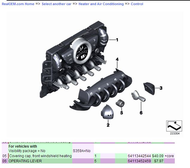

From what I see on RealOEM, you coul buy the one toggle missing for 8$. Now, can this be installed in the cluster as-is? Can't say

You can install the missing toggle but it is not a switch in the sense that the toggle does anything. The toggle actually presses of the 2 small buttons on a printed circuit board behind the toggle. You cant use the "extra" toggle to add anything after-the-fact. For the $7-$10 most vendors sell it for, it fills the area out nicely.

My guess is that you would at minimum have to drill out the plastic. Hopefully there are still mounting studs for it behind.
And if that works, it will only press the existing PCB. But combined with fes's auto-sport circuit, if all of these things are true, then each could be used to toggle an accessory and still look stock. (That's a lot of ifs)

Fairly easy. I have seen it done two ways. The quick and dirty way involves just popping the cover off that goes around the switches. It looked like it would break but it was a tech doing it and he had no issue. The how-to I have seen on here involved removing much more plastic to easily pry the plastic off and see more on the sides of it before yanking.
Once the cover is off, there are two little plastic flaps or prongs that go over raised parts of the cover panel and the blank pops right off with a small pry or screwdriver that techs carry in their shirt pocket.
No drilling, just tactful pulling and prying. The new toggle just pops right into the board at the fulcrum point and it will press the two micro switches on the board and do nothing.
