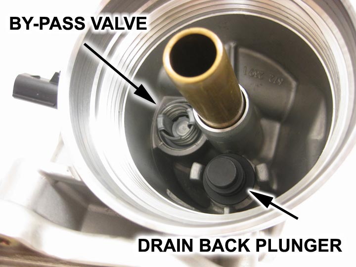

I put another oil filter in yesterday. The one I took out seemed 1/2 longer than the new one - and was warped on the end where it would touch one of those valves.
It's running/starting better - and the half power light isn't coming on at all now. But I'm still losing oil someplace into the induction...
Would blocking those cause a pressure spike into the turbo seals?
