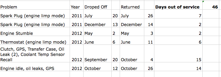

Mojito's Avatar
Mojito
Joined: Apr 2011
Posts: 659
From: Kirkland, WA
Old Jan 28, 2013 | 02:37 PM
fkelly5's Avatar
fkelly5
Joined: Dec 2012
Posts: 119
From: Charlotte, NC
Mojito- so its now 2013 and how is she running. Like a well oiled machine. Love the spreadsheet.

Mojito's Avatar
Mojito
Joined: Apr 2011
Posts: 659
From: Kirkland, WA
I am debating whether to trade-in my high mileage but excellent running 03 Honda Pilot or to hold onto it for exactly what you experienced (days in the shop).
She's back in the shop again today, misfiring again. 22xxx miles now. Auto temp control wasn't working for a while too, but seems to have fixed itself.
Old Jan 28, 2013 | 05:24 PM
Braminator's Avatar
Braminator
Posts: 7,242
Likes: 55
From: Wherever she takes me.
This does not sound good for a 2013.
