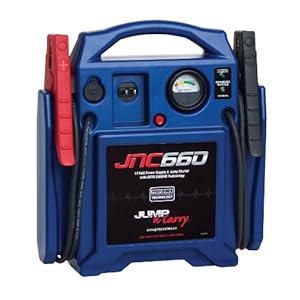

Also. You might want to carry one of these so you could jump your car yourself. Just incase.....
