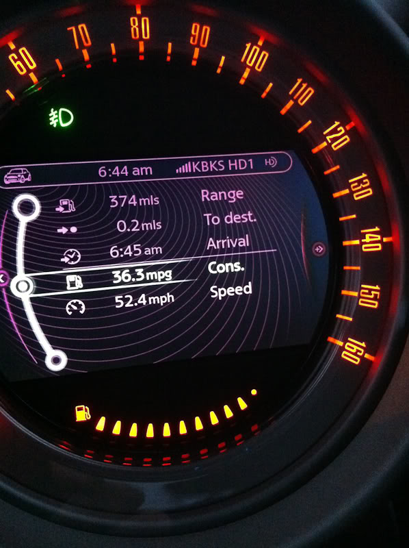

That's terrible.
I avg 28 mpg with a heavy foot, get over 30 on the hwy and gave gotten 36 on my work commute (25 miles, 24.5 on the fwy)
Old May 8, 2012 | 07:03 AM
  #93
Mojito's Avatar
Mojito
Joined: Apr 2011
Posts: 659
From: Kirkland, WA
