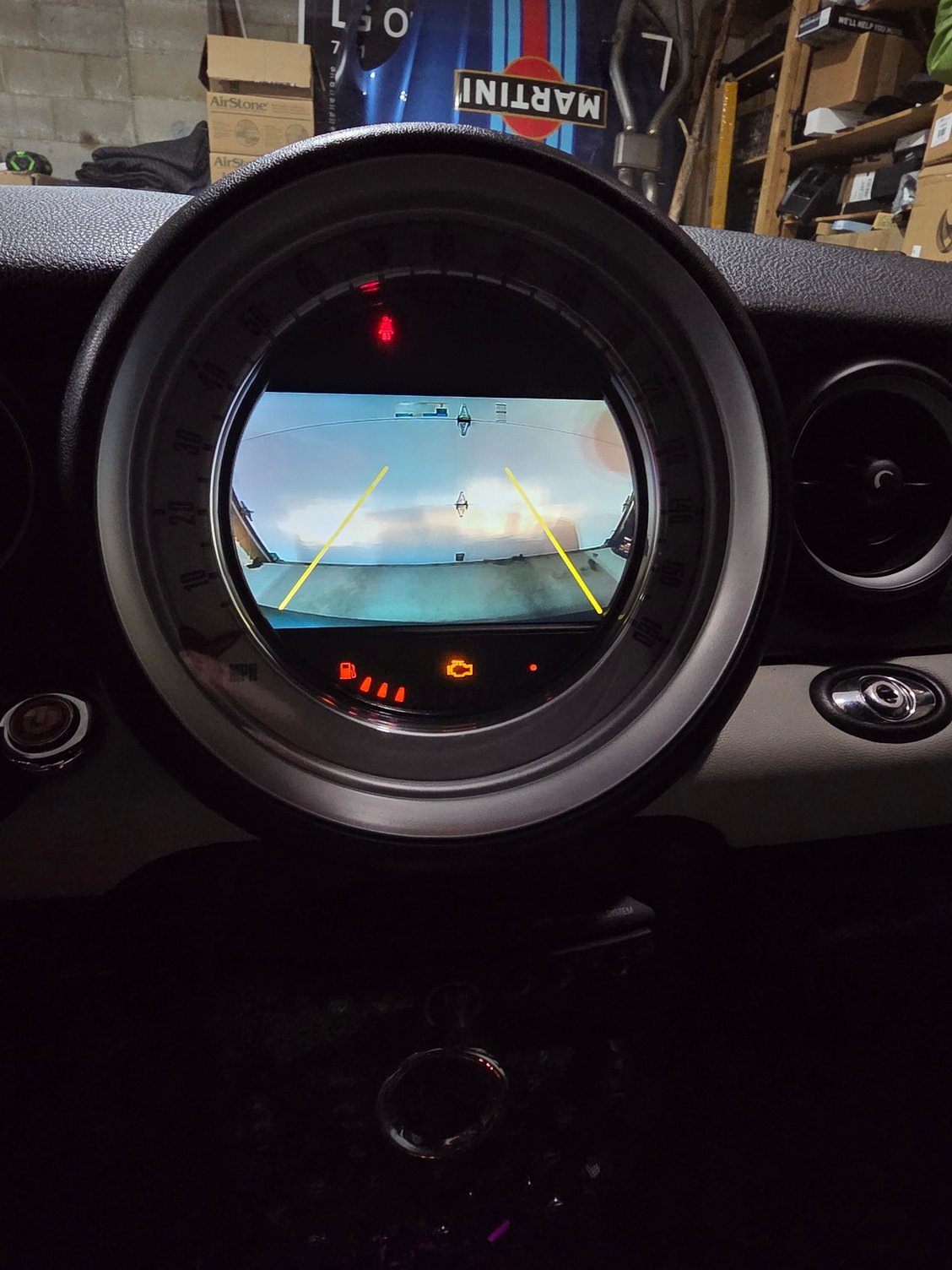

There were a few curveballs here, but wanted to share that by and large this is a straightforward install, if time consuming. I couldn't find any documentation on the r59 install, so just dove in.
1) if you go with a license plate light cam, you have to solder on the wires
2) you have to drill a hole in the license light handle, and the trunk lid
3) the autoabc install video walks you through the box, largely
4) it fits perfectly under the CD player, plenty of room
5) you have to remove quite a bit of plastic - trunk lid cover, firewall speaker panels, etc -, to route the wiring into the cabin. Be careful, these are super brittle from age.

I would have gone with one of the big screens - touchscreen is definitely nice to have - but every one I've encountered doesn't seem to fully integrate, and/ or loses some measure of oem functionality. Last I looked, none of them support setting the clock, which I would find annoying. A whole back I tried an aftermarket lcd gauge cluster, and it gave me a cel.
It's actually surprisingly easy to use - the rotary controller works perfectly fine. It's not fiddly. 10/10 would recommend. It does come with an external mic, which input on the a pillar, and it works fine even with the top down.
