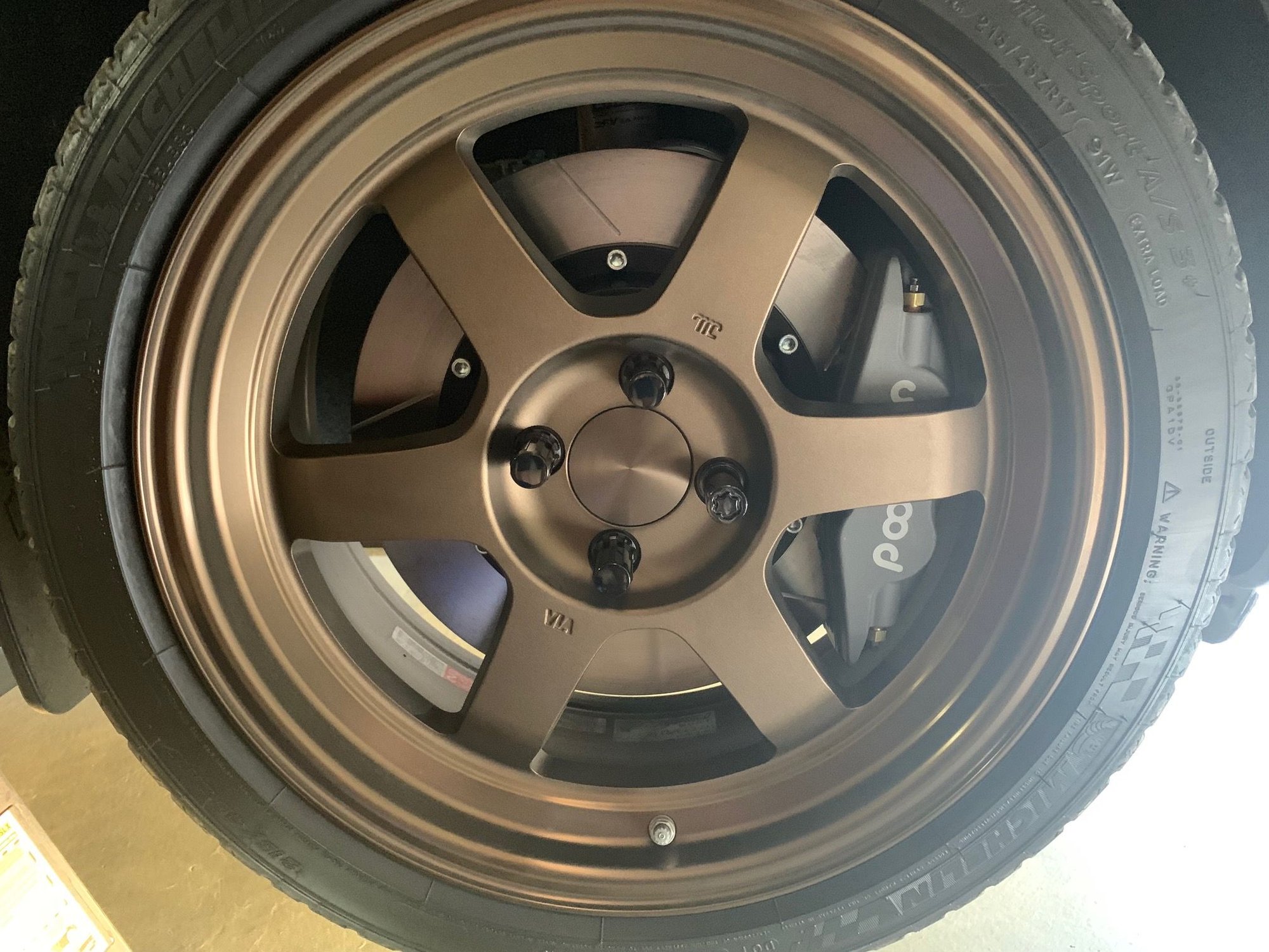

I have the 13" TCE kit on my R56 S and have put ~20k miles on it. The kit has performed admirably so far, I'm running the same rotors that came in the kit and have done 2 track days on them with Poly B pads then swapped back to BP-10's for street use.
They brake just as good as the OEM setup for daily use but no better. I don't really notice an overwhelming increase in front brake bias to OEM and the rear doesn't swing around on me under heavy braking, so far. A common misconception with BBK's is that suddenly your car is going to stop on a dime, that's not why these exist. A BBK is going to increase your resistance to brake fade or the effect of stepping on the brakes and not slowing down due to the heat of continued heavy braking causing the pads to off-gas during braking and preventing the pads from making contact with the rotor.
You will however notice an increase in noise; going over bumps the pads bounce around in the caliper, lightly applying and releasing the brakes in stop and go traffic results in some tapping due to the slots in the rotors moving the pads in the calipers when not under braking pressure. They do however hold up to heavy track abuse much longer than the OEM setup, so if you track the car frequently well worth the investment.
BBK's also incur higher maintenance costs, my costs are: HD Rotors (thicker, more heat dissipation capacity) ~$200ea, Rotor Hats ~$180ea, Pads ~$138 for Carbotech 1521's / $197 for Carbotech XP10's. I included Carbotech's here as I've had better results running their pads on the rear and that's what I'm replacing my fronts with next.

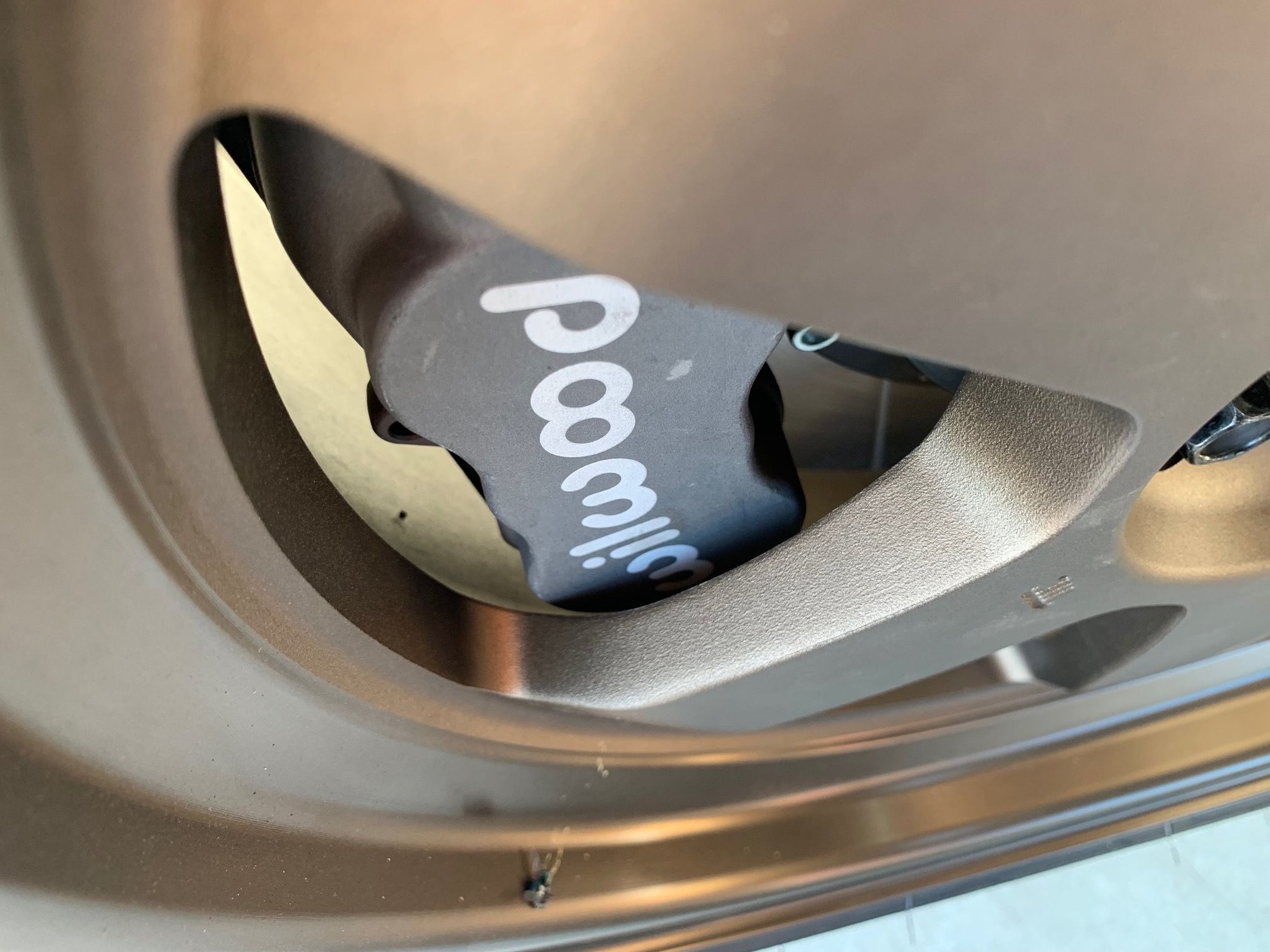

Edit: Added a few pics since you were curious what they look like on a BRG car.
Oh I forgot to mention, the other thing to consider is caliper to wheel clearance. In order to fit this kit I had to ditch the OE wheels and also run custom wheel spacers to maintain hub bore alignment and clear the calipers due to my chosen wheels offset. Even with the RP01's above I still have to run a small wheel spacer to clear the calipers. You could go with the 6 pot caliper vs the FSL, which is apparently much more wheel friendly, but you forego the easier pad change (this should be a negligible consideration unless you're tacking frequently) and some of the increased brake fade resistance as the pads are thinner as well. Oh and due to the spacers and wheels I had to swap out to an extended wheel stud kit too. Little things add up.
