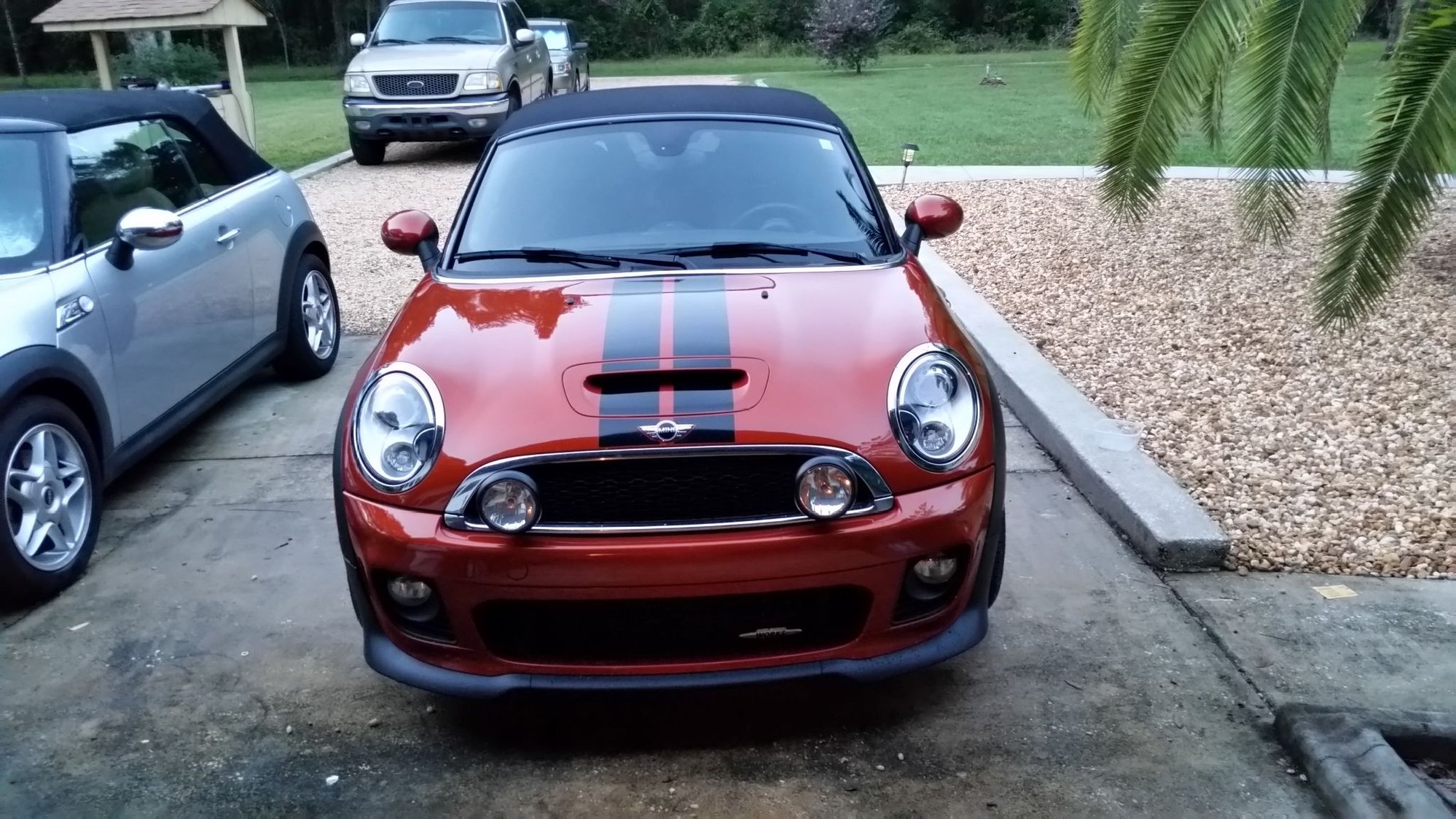

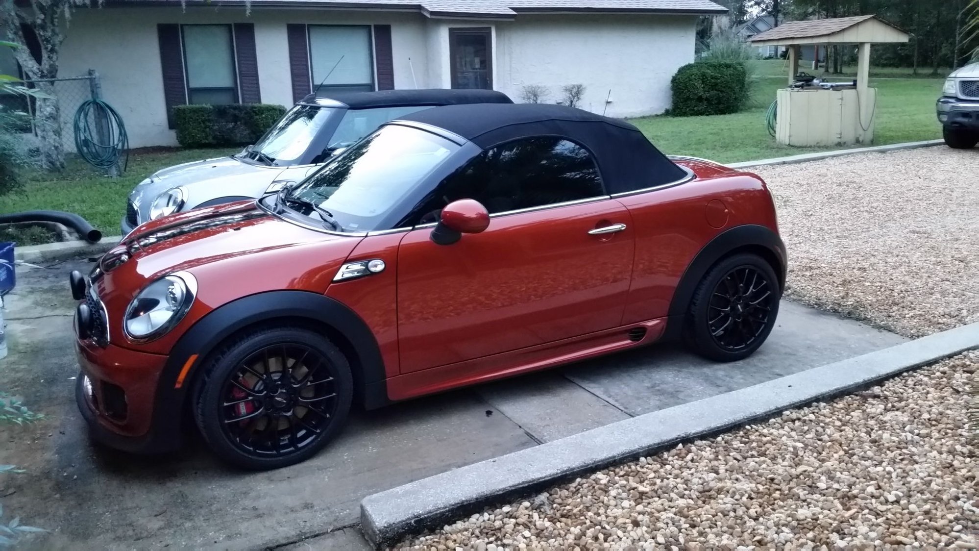

Mama's new wheels
The wife gets an upgrade to a 2013 JCW Roadster. I bought her a 2009 MCS vert two years ago and she just fell in love with the Mini brand. We stopped by the Mini dealership a few months ago to pick up some parts and she fell in love with the JCW roadster on the showroom floor. I liked the car but not the 42K sticker price so I started testing the used market. There were two for sale fairly close to home but both had automatics and the wife said no. Finally found a manual JCW at a Mercedes dealership in south carolina so after lots of emails and pictures we drove up for a test drive and this was the result.
Carbon black leather interior,Nav,Sirius,Mini connected,harmon kardon,heated seats,comfort access,xenon lights and auto dimming mirror. I already swapped over the koni FSD shocks from the 2009 which really improved the ride on the run flats. More miles than I would of liked at 42K but after inspection and some haggling the dealer came way down on the price and no dealer fees so I felt I would not be able to find a better deal in the southeast. Happy wife=Happy life.

Nice find! Looks in great shape. 42k miles... heck it's almost broken in! Great color, too. Happy lucky wife!

Congratulations! Great find. Love that color.

I looked at three JCW roadsters locally and they were all black with red stripes. The wife thinks the spice orange metallic looks perfect with the black trim/stripes. Thinking about going with the black headlight and grill trim.

I would, since it already has the black Challenge wheels and black stripes. Would really look good on that JCW.

Nice Spice Orange, original Hot Orange owner here. Love the orange. Congrats
The spice orange is very rare on a Coupe' or Roadster.
Also the black trim is here and would look great with the black wheels combo.

I'm not completely sure, but I think that Orange is still the new Black! And rare. I've only seen one Orange Roadster, and just briefly. I was headed south on I-95 in North Carolina, and the Orange Roadster was headed north. Stood out on a sunny day.

I agree! For the grille: 51130417135 here (upper portion) is the black trim for the grille, also called the "air inlet finisher." 51130442011 here is the lower portion of the grille. Or you could change it all together and go with the M7 Speed Ultimate Grille for a much cleaner look.
