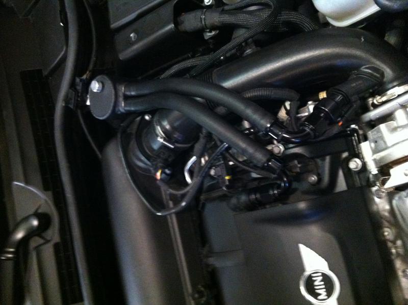

Just installed a BSH catch can. Installation was simple after I threw the instructions away. Typical. Simply remove the engine cover to gain access to the PVC hose connector. Remove the PVC hose. Install the adapters at the hose ends. Mount the catch can and run the hoses.
