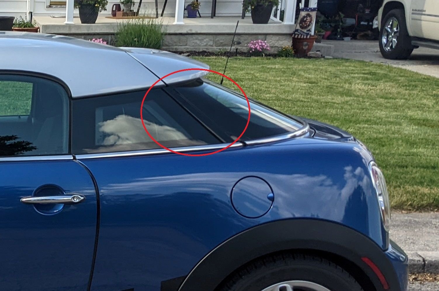

C pillar trim removal
How does the read circled trim come off?
I need to remove it (preferably without breaking it) I am assuming just several plastic clips underneath.

In particular pry it off from the window side or from the rear hatch side?

OK, I couldn't wait. I got it off this evening. No plastic clippy clips, double sided tape. NP, I have some. More a PIA to clean off the old than it is to apply with the new
