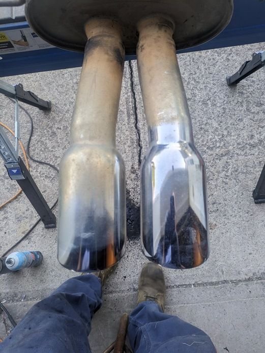

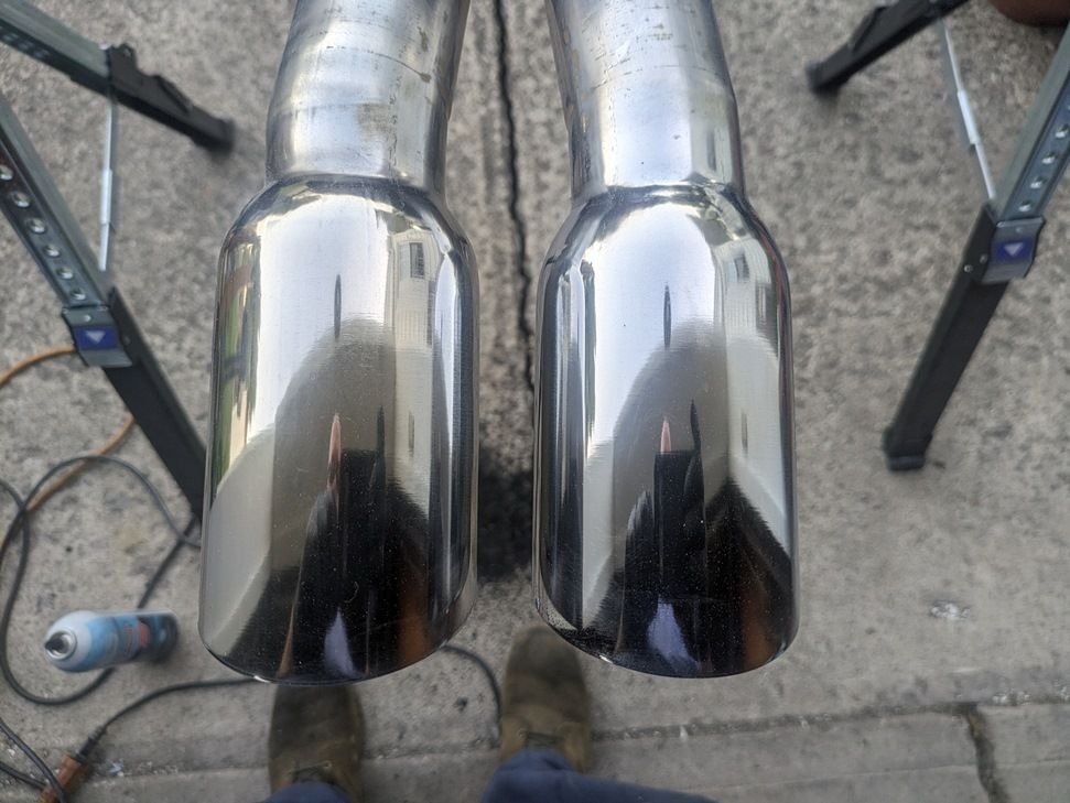

The JCW exhaust needed some love before I installed it.
Lots of elbow grease, polish and a wheel on a drill.
One side done, now the other.

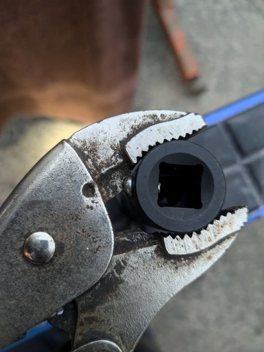

Life has been busy. Haven't had much time to work on it. Last PM I changed out the front struts. I don't own a pass through socket set so I got creative.
I used my deep impact sockets and found a machine screw that was close to fitting the hole for the ball detent.
I then clamped a vice grip to it. The screw prevented the vice grip from slipping around the socket. Worked like a charm
The stock strut came with a 21mm nut and the Koni had 19.

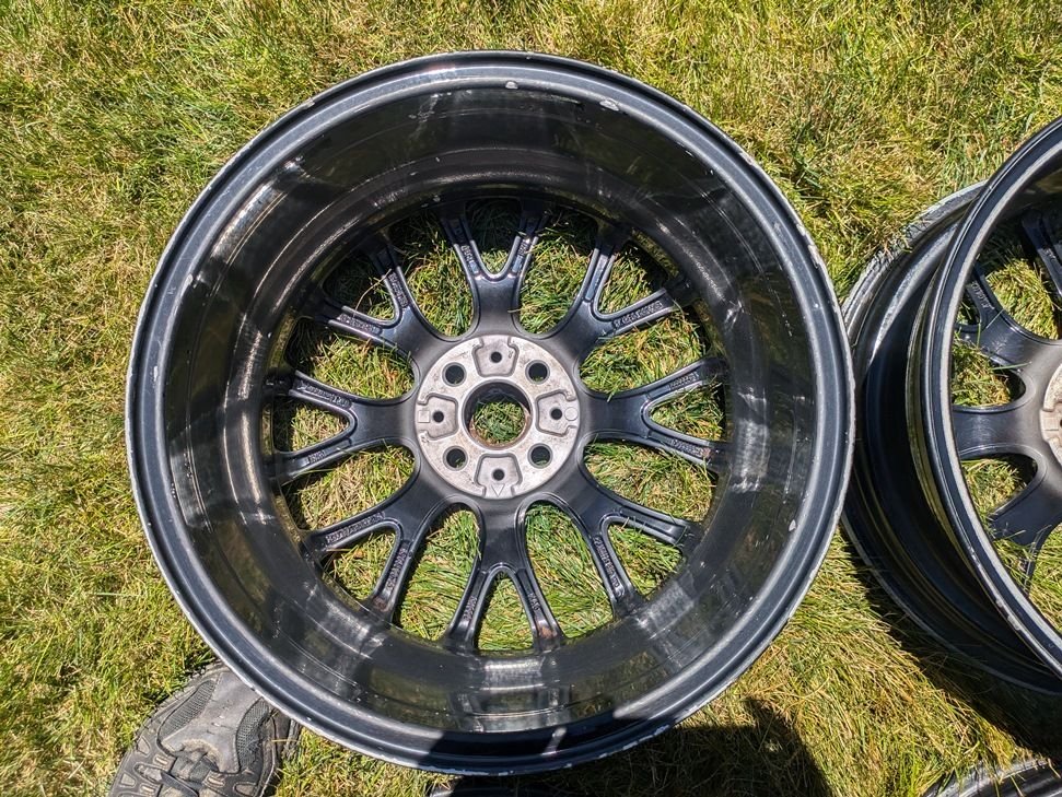

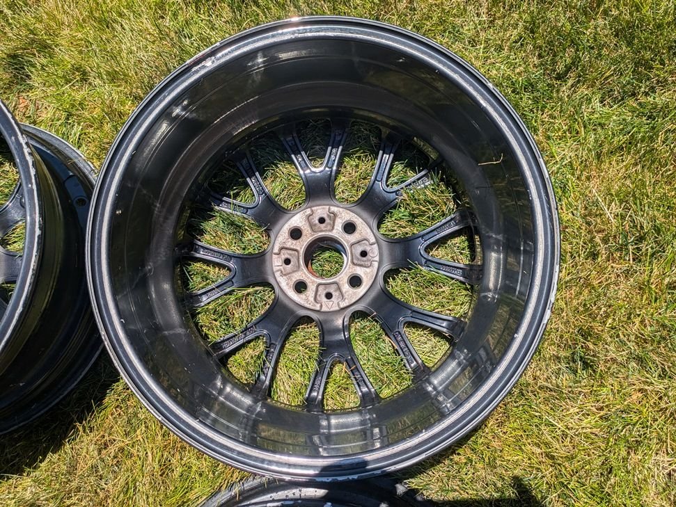

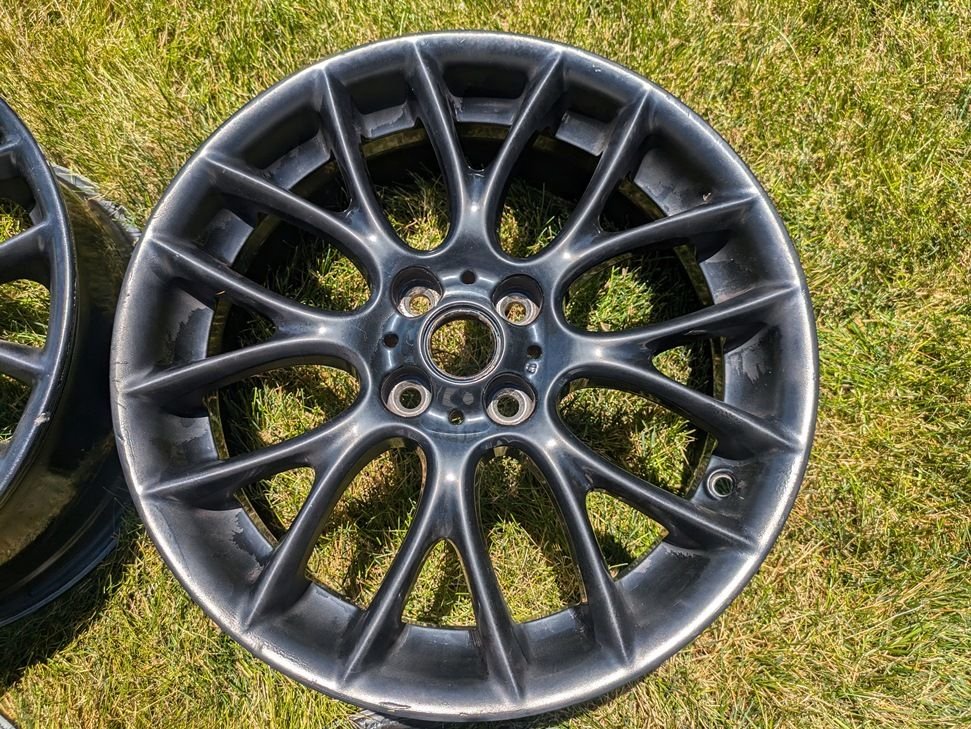

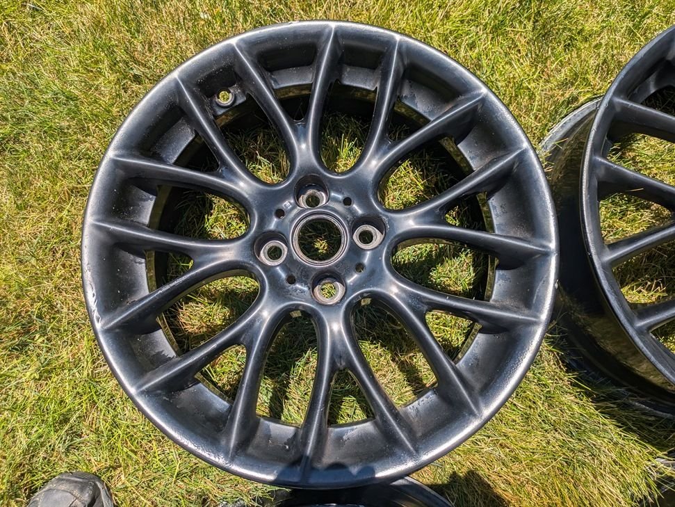

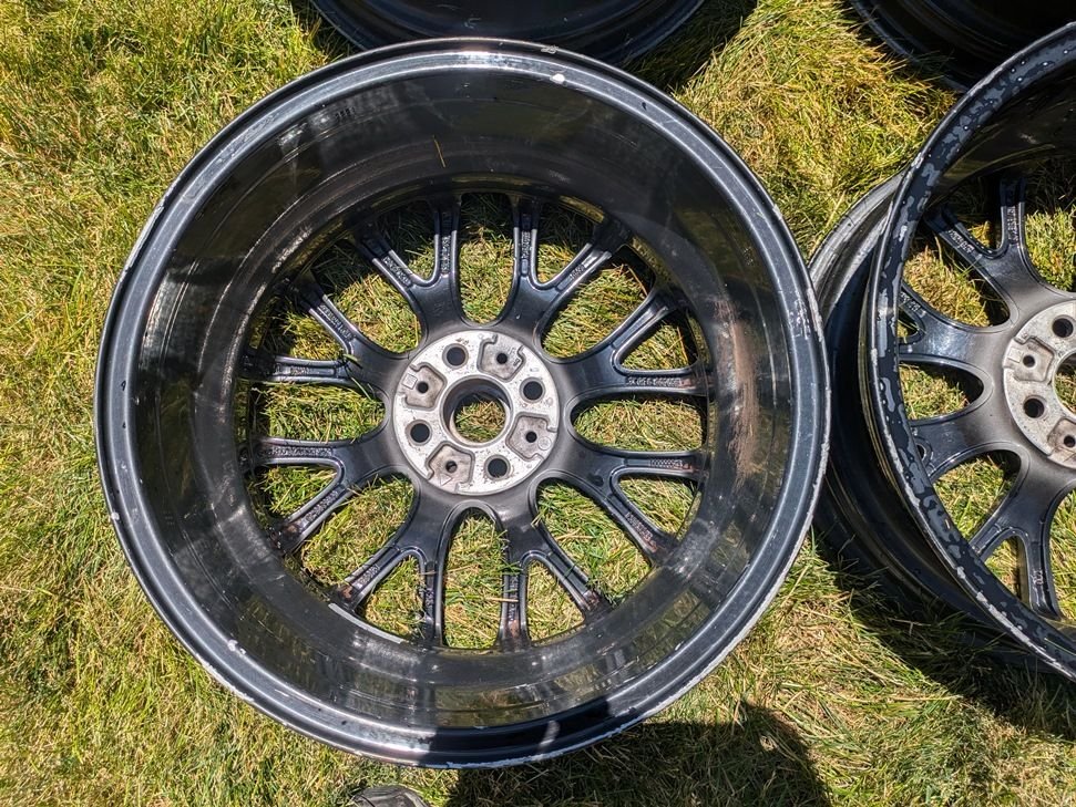

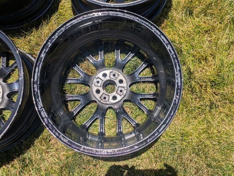

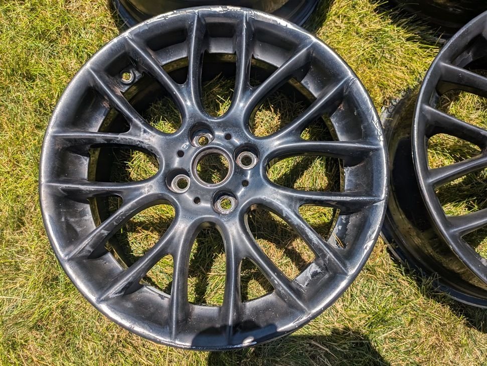

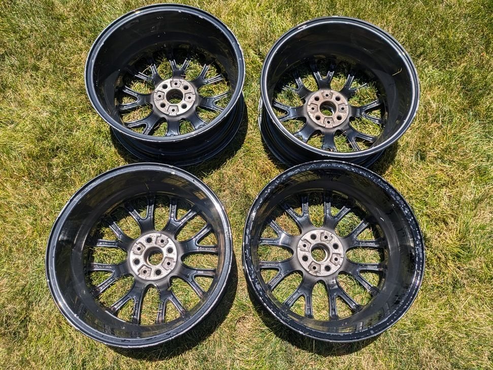

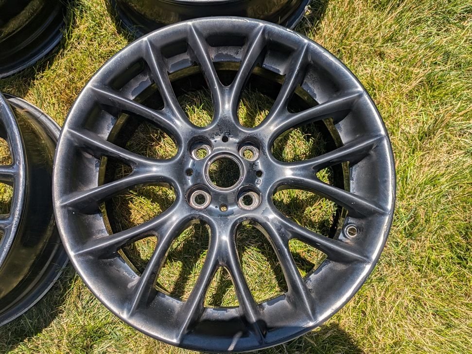

Rims are stripped (had a powder coat place do it, $100 for the set wasn't bad), lightly blasted, repaired and ready for paint. Wanted to start today but humidity was high 80%. It is only supposed to be 40-50% tomorrow and Saturday. Hope to spray the epoxy primer tomorrow, base and clear on Saturday.
I have some before pics. As you will see, they needed some serious love.
The barrels were no better

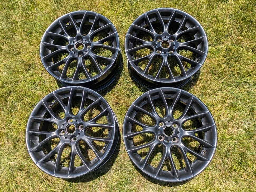

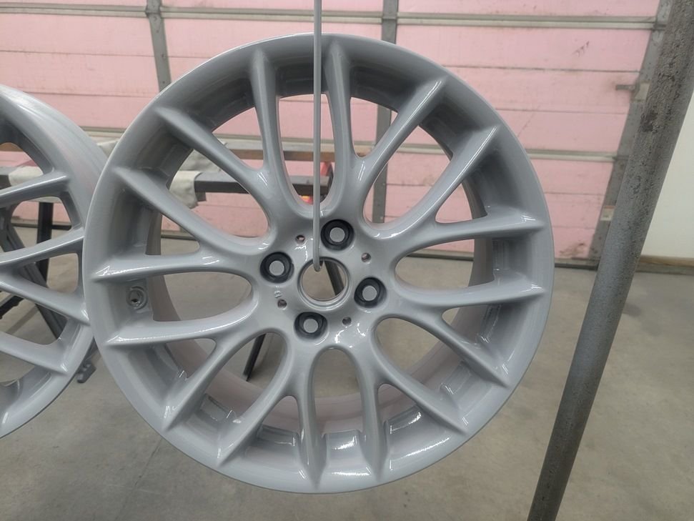

This is a rim after wiping it down before the epoxy primer
1st coat of epoxy on
Doing a second coat in an hour or so. Tomorrow is base Jet Black and clear.

I ended up using some spot putty on them and I don't think it will take the heat when they bake it on. Also, it has been almost 40 years since I did any automotive spray painting. We didn't have HVLP guns or all the different paints we have today. This will be the 1st job I have ever done that wasn't a lacquer or enamel. I considered the rims my "test" shoot before the body panels and Aero kit. If I completely messed it up, I could quickly clean them. Don't want to do that with the plastic pieces. I did get runs on my 1st rim, one small run on the 2nd, 3 & 4 look great (#4 pictured of course, we don't show our B sides). I am wet sanding out the runs this AM and doing a second coat as well. There are a couple cool things about epoxy, pot life after activated 72-120 hours, can be sprayed with base with no sanding up to 7 days later, has great rust protection when used on bare steel, needs good mechanical adhesion so rough sanding and extremely durable are a few. The only real downside is the cure time 12 -24 hours before base or sanding.
Since starting this repair, I have done a boat load of research on DIY for all the upgrades I did and also on the whole paint process. Years ago, you had Dupont or crap paint. Now there are many good paint companies. I went with Southern Polyurethanes (SPI) epoxy primer and Euro 2020 Clear coat. They have a huge following for both those product. They also have a very informative forum. Dupont is now Exalta I am using their Chromabase.
Epoxy sprayed similar to 1K primer and the base coat should spray similar as well. My only concern now is the clear coat. That can be tricky stuff to do and not get runs.
