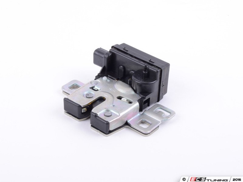

Hello, Its might need adjusted on the latch as the R58 (i have one myself) is a little hard to get close solid, its just the nature of the lid i guess.
I had mine adjusted at the dealership under warranty, they spun the adjustment out and mover the latch around to better close.
https://www.realoem.com/bmw/enUS/sho...diagId=41_2168
#7 and #6 and #5
https://www.realoem.com/bmw/enUS/sho...diagId=41_2169
#3 and #2
Trigger switch is in the latch itself, so if the trunk shut fine and it fully engaged then its a bad trigger switch.
https://www.ecstuning.com/Search/Sit...h/51242759608/
