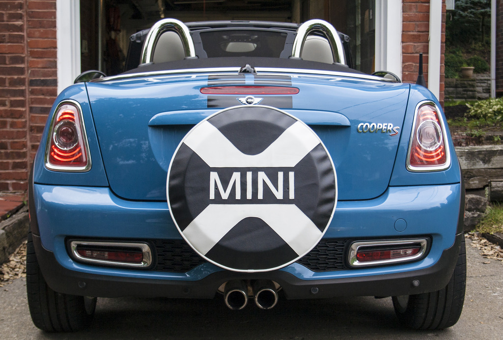

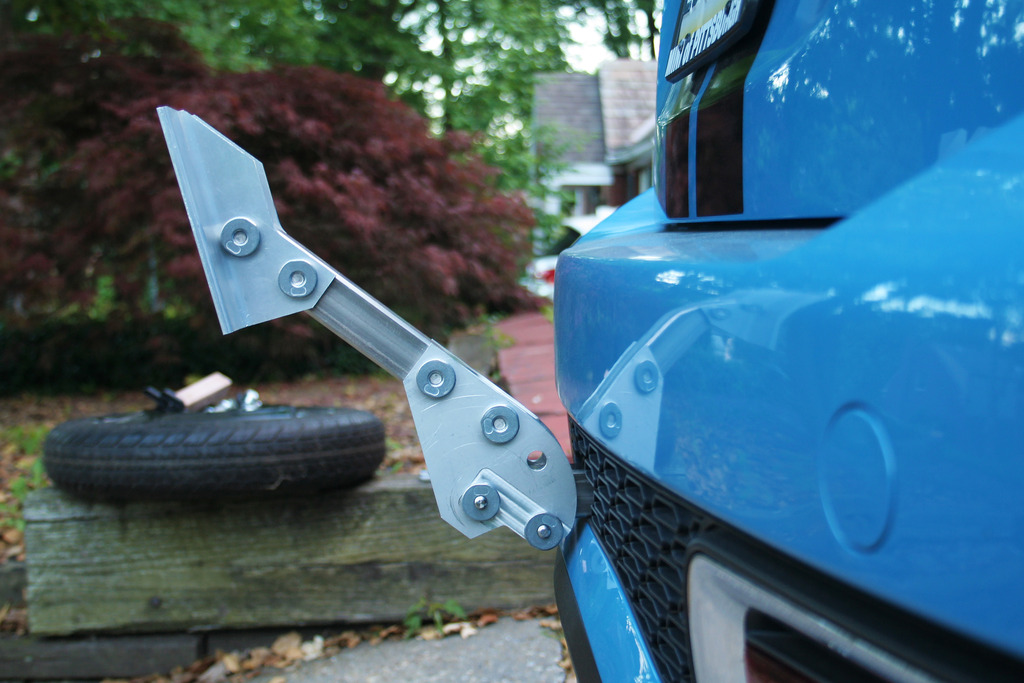

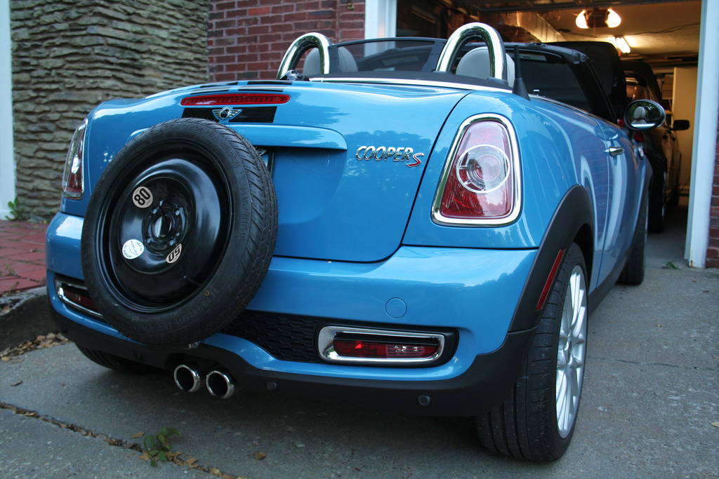

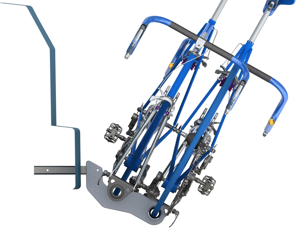

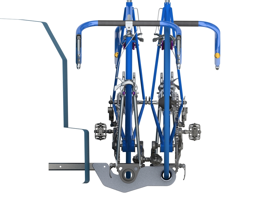

As DonGood Mentioned I was looking into bicycle rack as well, and I have to get back to this project soon if life can give me a break with all the other things
Last summer I started to work on this:
But got derailed by a road trip last summer which turned out to call for this:
So maybe this year I can get this rack done!?

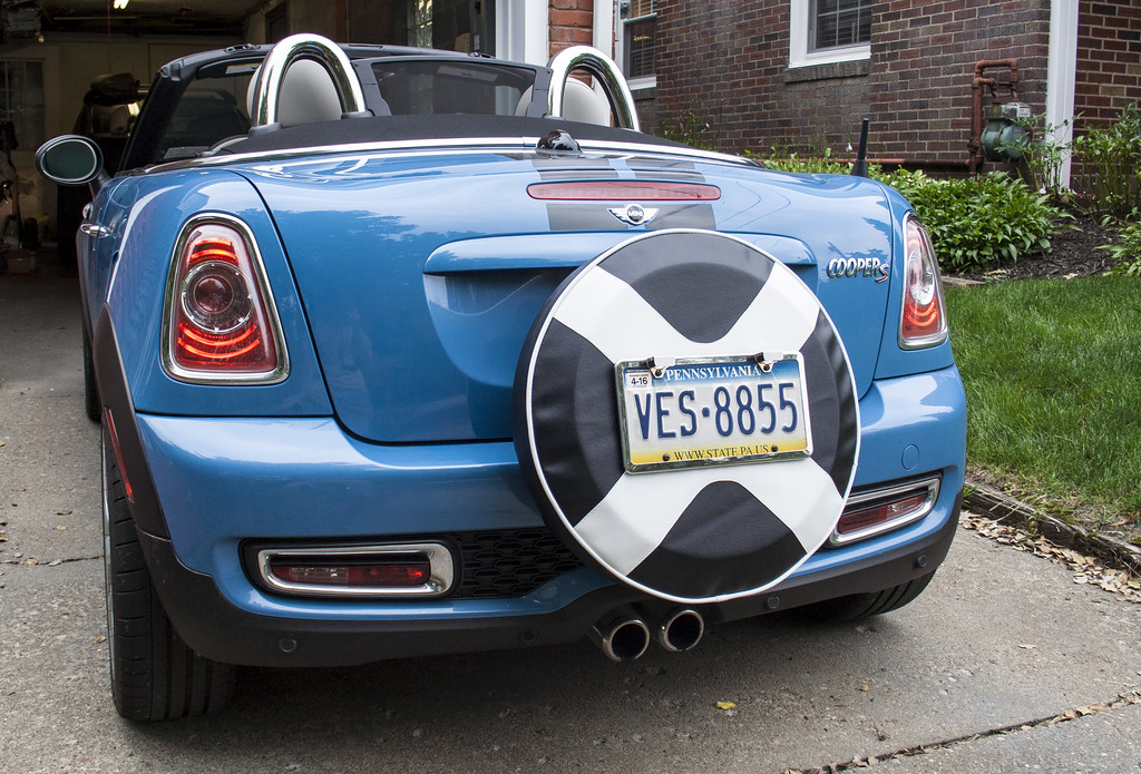

Here are some pictures of the torkcentral receiver hitch.
The tip back feature also trunk access with bikes loaded..

That torque central hitch looks awfully close to the exhaust.
No chance of vibration?
Old Sep 17, 2016 | 10:53 AM
3whit's Avatar
3whit
Joined: Apr 2008
Posts: 15
From: Vermont
Closeness
I have not had any hint of vibration or rattle .The pictures angle makes it appear closer ,there is a strong 1/4 inch around. I have been extremely happy with this set up. Easy on and off , and the Yakima Two Timer Bike Rack comes with a lockable threaded hitch pin..Not cheap but I think its the best , no holes cut in your bumper cover .No Bumper cover removal for install , Takes less than an hour to install with standard tools . Capable of towing small trailer also ..Check out their website ,they have a video of the installation on a Mini Cooper S. , My wife Mini pictured is a 2012 Mini Cooper S, Coupe, R58
