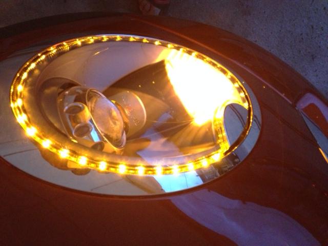

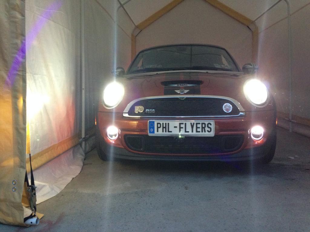

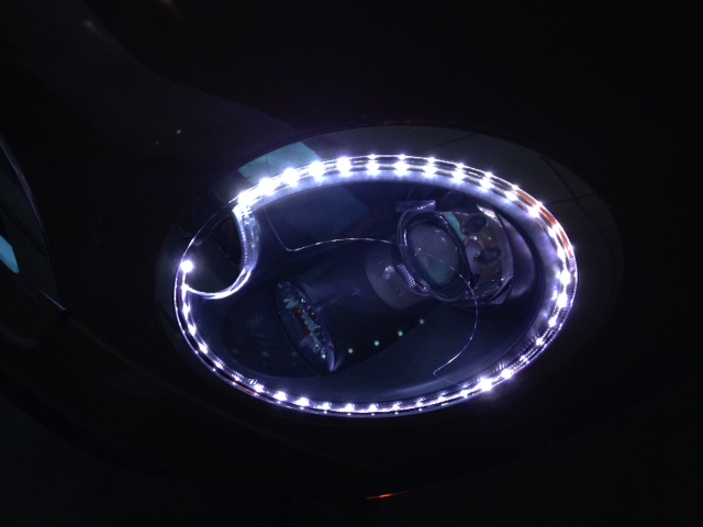

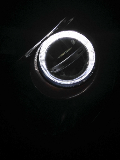

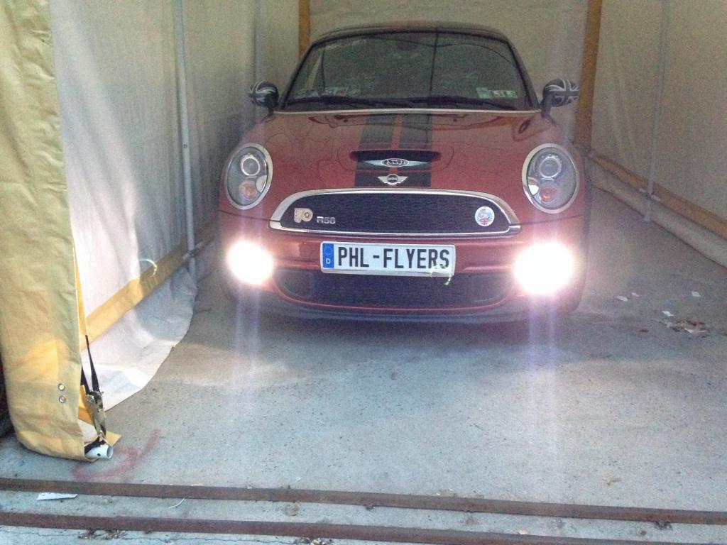

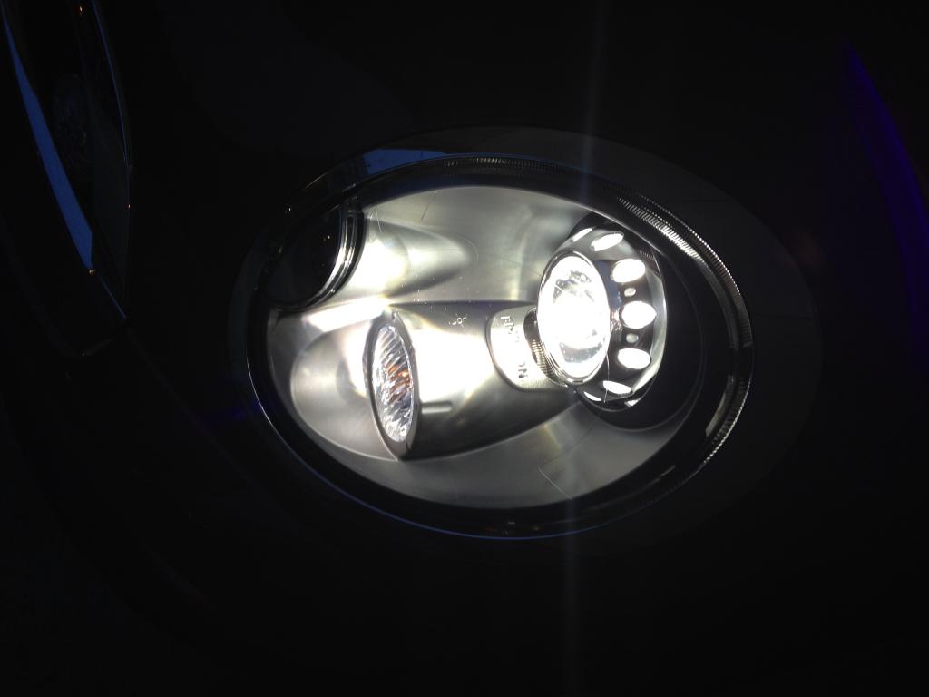

I just had the Xenon Retrofit Headlights installed at the dealer on my 2014 Mini Cooper Coupe S and love how bright they are. Only problem is that they were not adjusted correctly and I had to readjust them today so that they fit in the hole in the hood and seat correctly. My Mini is going back in this week for the Retrofit Fog Lights. I wanted this combo when I purchased my Mini but the Coupe I purchased didn't have the Xenon Headlights and only had the regular Fog Lights. I didn't want to void warranty and was told that if the dealership installed them that they also would be covered in the original warranty of the car. Will post a picture later this week.
Old May 20, 2014 | 06:27 PM
  #37
PHL_FLYERS's Avatar
PHL_FLYERS
Joined: Oct 2012
Posts: 168
From: Philly

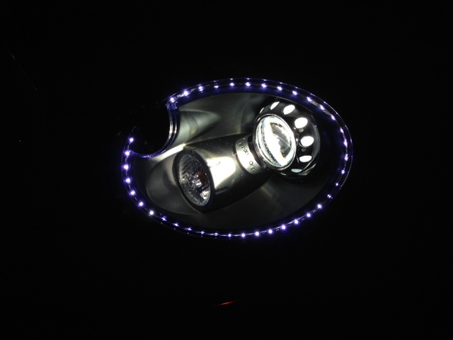

Pictures of My New Xenon headlights and also the LED foglights also I added some style to the headlight.
The Headlights now also serve as turn signals. I'd say functional headlights. Let me know how you like them
