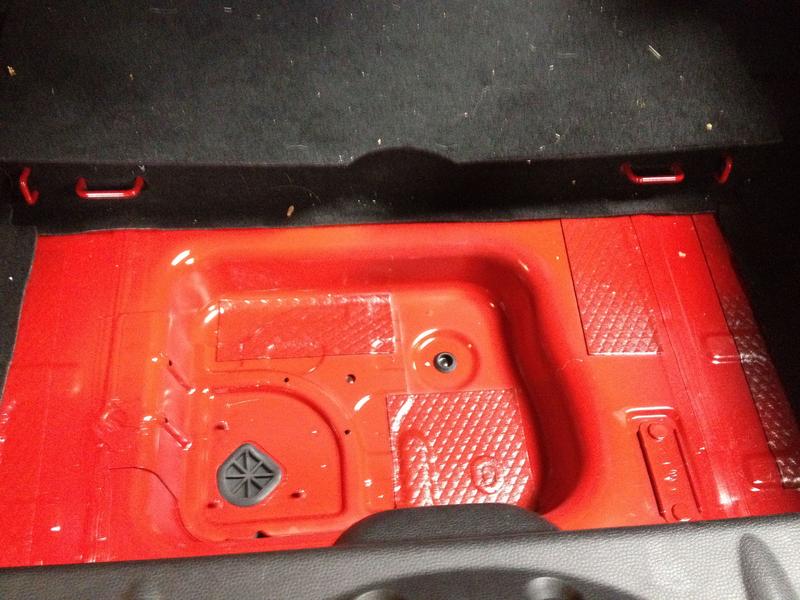

The grommet to pass the lines through the trunk are under the jack kit. I would get a left side tank if I had to do it over again. Shorter run with where the grommet is.

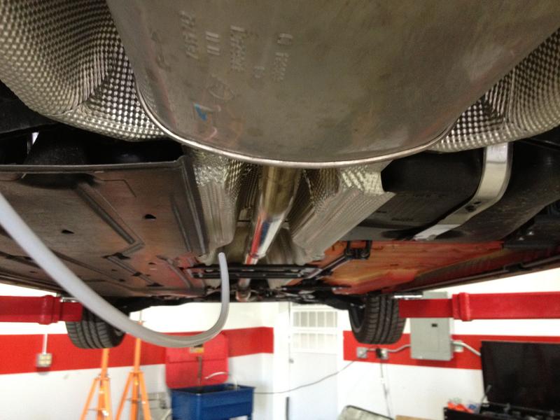

The lines come out on the right side above the exhaust, which I then threaded over, behind and around the heat shield. In order to run forward you have to take off the plastic cover on the right side. 9 10mm nuts, 1 10mm bolt, 1 screw and 1 torx later... you see the fuel lines to zip tie to.

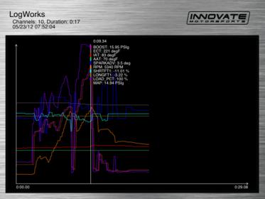

Beyond the car pulling harder (not sure if this is just due to battery disconnect and clearing of the fuel trims), previously when going WOT there was variation to the power delivery. Now I would describe it as smooth and consistent. Idle seems smoother too.
Here's a pic of the OBDII date from my OT-2 setup. This shows a hard acceleration from a stop light through 1st and 2nd gear.
