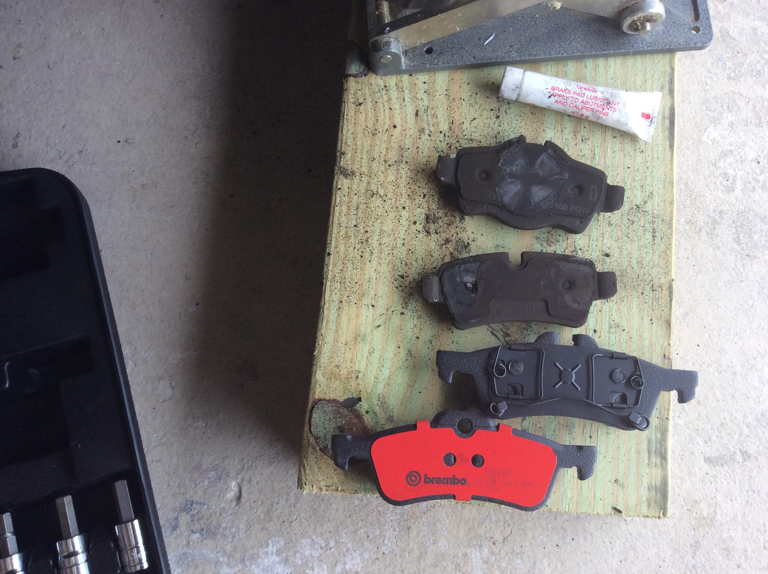

I ordered some Brembo ceramic rear pads that were listed as compatible with my specific vehicle. I went to install them and they were way too long. I attached a picture. The place lists them as the correct pads but they do not fit. Am I missing something here? The tabs that fit into the slots look nothing like the originals.
I did the front with no problems.

those are GEN1 rears, R52 in your case
your 2009 is GEN2, R57
notice those spring clips on your new pads ... a GEN1 thing ....

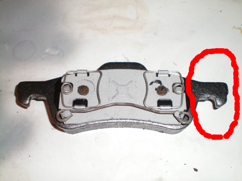

OE GEN1 rear pad:
GEN2 rear:

^ nailed it. Yep it's the older gen brakes.
