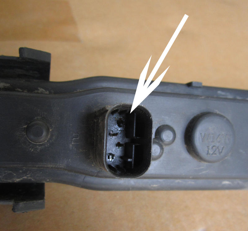

Found out the problem......I think
So, I had my wife stand behind (and off to the left a bit) my car to see if the backup lights come on. Found out that neither the backup or brake light come on in the 3 bulb unit in the rear bumper. Took it apart and all the bulbs were good but no power was getting to the bulbs. Took the connector apart and found one of the prongs burned out. Not sure how well it shows in the photo, but hopefully this will help someone else out in the future.

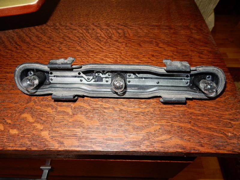

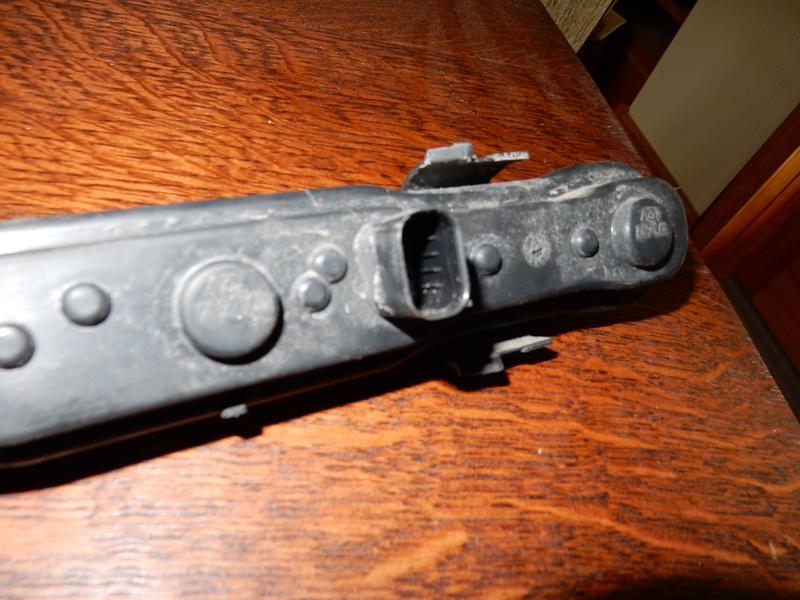

It's at it again.
I had the problem fixed by the dealer before the warranty expired, but now at 43K it's on me. I took it apart today and found 2 spliced wires that the Mini dealer repaired but it looks like they never replaced the long black plastic piece nor the connector. Here's a photo of what I need. It has part # OLSA 03.455.04.0 on it and it houses the 2 backup lights and the brake light. I also need the connector plug that goes into it to properly repair the situation. If the price is too high, I'll bet I could solder a wire to the inside and feed it through a small hole and splice.

This is the housing : That's for the R56 R57 Cooper ( NON S ) 2011+ 63247297417

That's the part I needed. I ended up repairing mine because the 4 prong connector was fried and I could not find a replacement. When I called you (ECS) the rep told me that he could only find a 3 prong connector. I wouldn't mind fixing mine the proper way if you have a connector available now.
