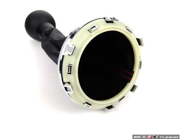

Do you have the manual transmission ?
Its not that hard for the manual transmission shift **** and boot. Gen 2 MINIs are connected unlike the Gen 1 MINIs.
First you will have to get a no marring plastic tool or a credit card / small flat head screwdriver that thin and try to protect the plastic if you use screwdriver.
Work around the base trim until it pops out. Then grab with both hand and pull up on the shift ****. Watch your face and the sunroof when you pull up. Replace in reverse, just make sure the **** lines up with the notch on the rod, then push down.

Exactly like ECS said. Get the base loose first. Then pull really hard! Don't hit yourself in the face though.

FWIW, I didn't remove the skirt when I replaced mine.
I pulled the **** off first, my readings were that it was attached firmly, takes a mighty pull. It is, and did, but not superhuman. I just made sure to stop pulling when it popped off to not tear or abuse the skirt.
Then: I separated the boot from the **** sleeve, using a butter knife edge to get it started.
10 minutes, if that.
