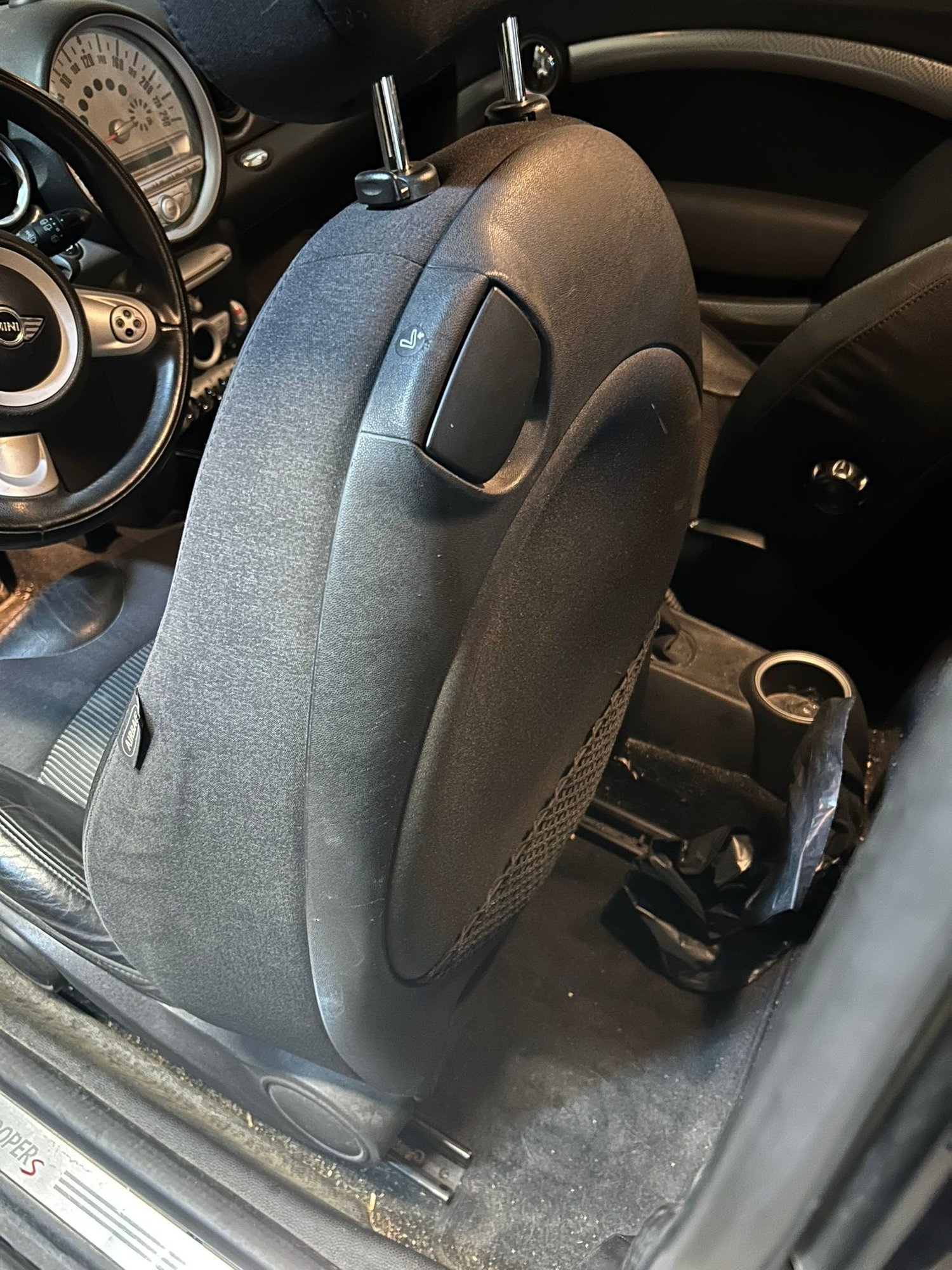

Hi,
The tilt forward , using the lever on the back of the front seat is broken. I am trying to figure out how to get the back plastic panel off to do the repair. There are no apparent screws. The only tidbit of information I could find was on youtube. After undoing the hinge screws and the lever screws, the guy just ripped the back off with his hands ! The seems like it could cause some damage to the plastic clips? Does anyone out there have experience with this? Photo of the seat model posted below. TIA!

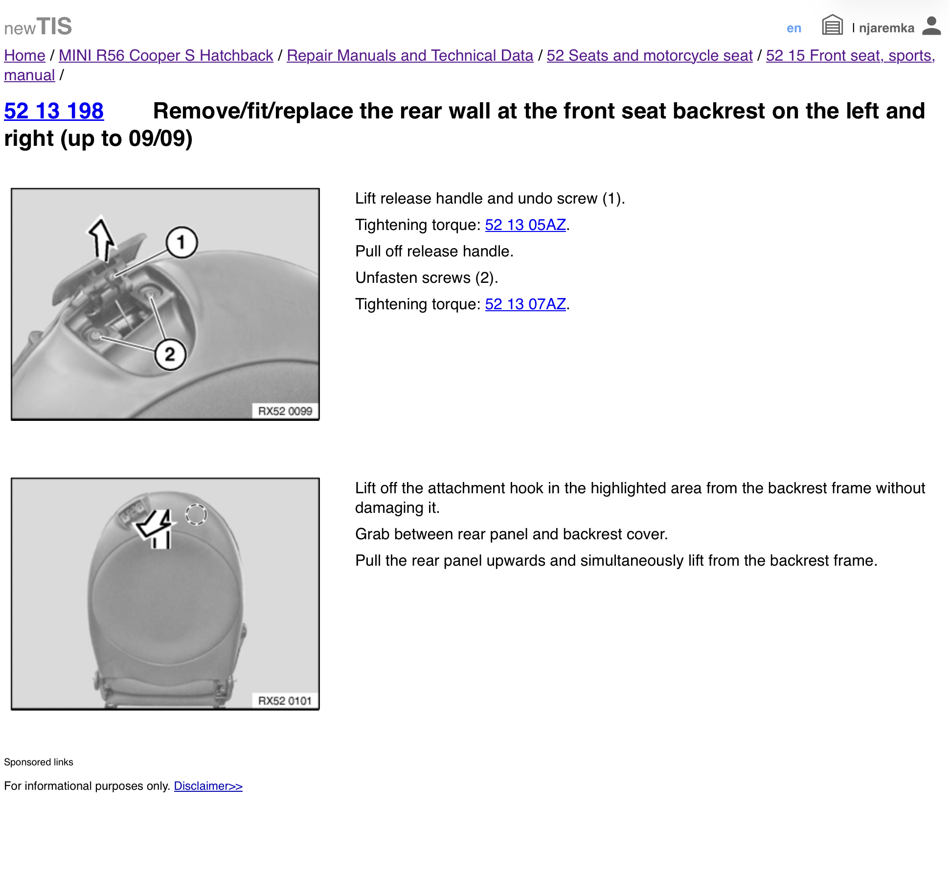

Here you go.

Thank you!!!!!!!!!!!!!! This is a huge help
