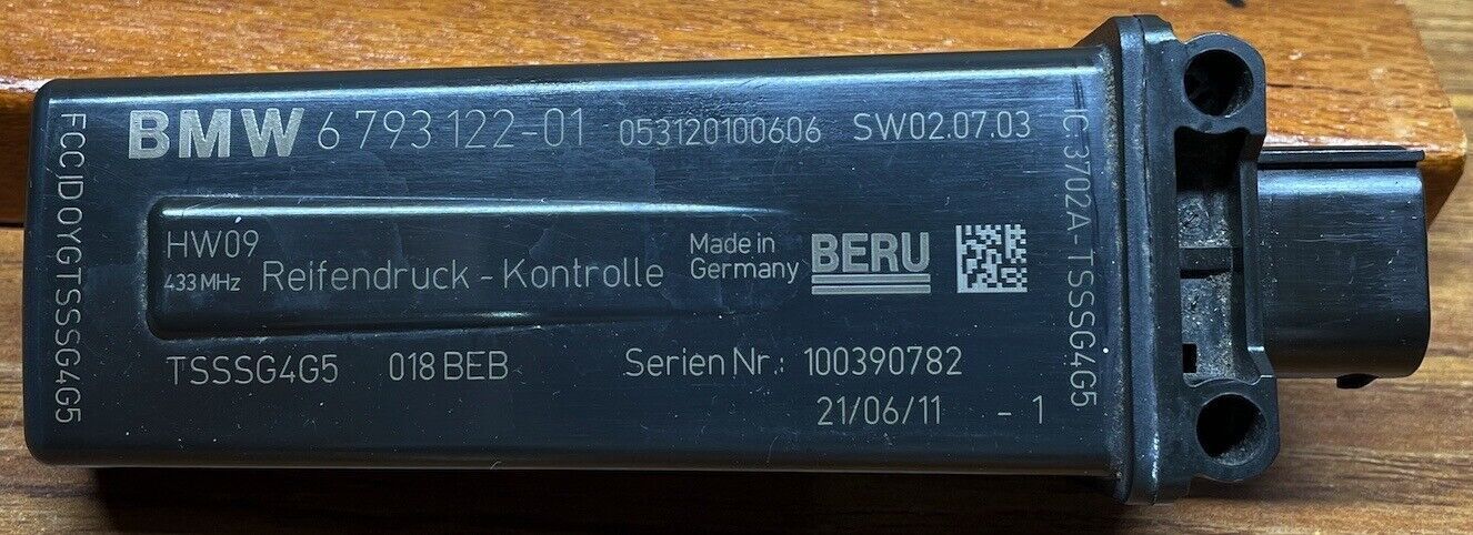

Keep in mind that if unplugging the RDC module eliminates D904 but no damaged RDC K-CAN wires are found, the RDC module may have an internal wire or circuit fault that is responsible for the fault code. Also inspect the RDC module for water damage, which is quite common.

Ha ha! I was so focused on the A/C work that I forgot that I had the two K-Can line faults last October when I replaced the battery. I paid a Mini technician on Just Answers.com who told me that it doesn't cause any problems ands to stop worrying about it.
I'm not too stressed then; however, I think I will unplug the RDC and see what codes show up.
Unplugging the RDC module will result in fault code A3C3 (Instrument cluster: Tyre pressure control, communication fault). But if D904 disappears, you're on the right track.

Wait. I forgot an important detail that makes testing the potential role of the RDC module in causing D904 much easier. Simply remove fuse F19 (source of power for the RDC module) and then check whether D904 disappears.

I pulled fuse 19 and got no D904 code. I did get C913 (JBE no message), A3C3 (Tyler pressure communication fault, E735 (No message, wiper IHKS etc.), A0B1 (CAS input implausible). What does this indicate to you?

With high certainty, the RDC module is faulty or the RDC module K-CAN wires are damaged. Inspect both. If you don't find damaged RDC K-CAN wires, a faulty RDC module should be considered first. I have a working RDC module (shown in previous post) that I can send to you.
The new codes are almost surely due to removal of F19 because this fuse also supplies voltage to other systems.

I went to LKQ (local salvage yard) and pulled another RDC aerial and the harness from the back of the car. Replacing the RDC unit didn’t change the fault code. It is still D904. I’m going to look at replacing the harness on the rear bumper now.

D904 fault is cured. No more faults. I found a tiny hole in a green K-Can bus wire that bled green corrosion. I picked up two rear bumper harnesses and one matched so I spliced it in (solder wires, heat shrink, over wrapped by electrical tape).

BTW, I also picked up an RDC aerial and swapped it but that left the same faults. That’s when I decided to swap the wiring harness at the rear bumper.
