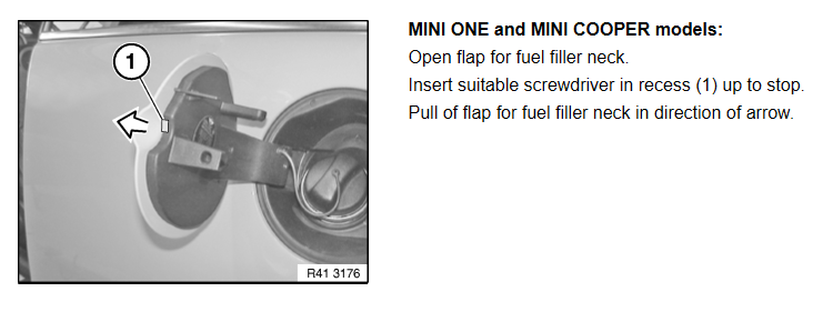

Has anyone figured out how to remove only the round flip open door cap, attached to the black plastic? I’d love to remove detach just the brown so I can dip it black
sorry not the best pic but it’s the brown door cover what have you on the left attached to black plastic.
strangely nothing on YouTube

Its easier than you think...

Woo hoo! Thank you thank you! I don’t have the same design but it was exactly the best help
