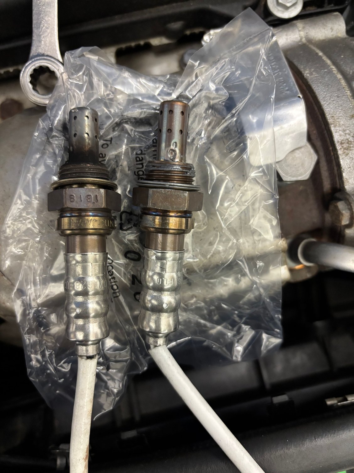

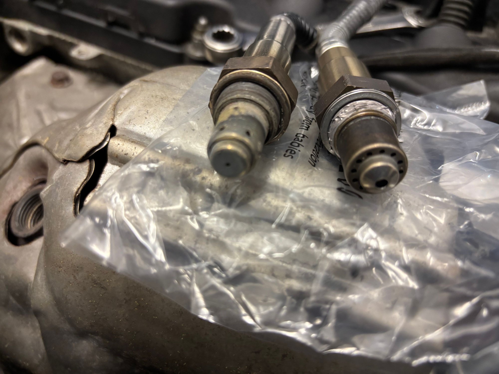

The top O2 sensor I believe is different aftermarket versus OEM #1 on R.
the lower appears similar but not at 200$ for aftermarket & 700$ OEM #2. On R.
& OEM they come pre anti seize applied so none gets on the sensor.
