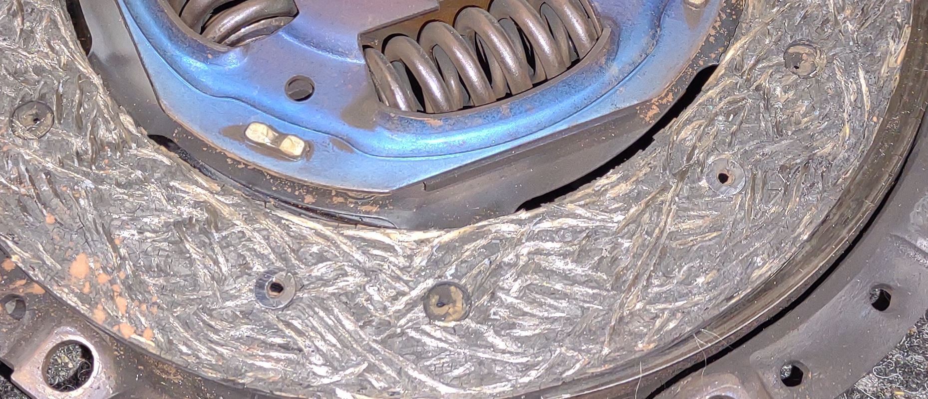

Well, I think I'm a happy boy. I got the transmission out (along with the subframe and a few hundred of its closest associates). Really not a horrible job - I'm glad this wasn't a car that had spent too much time in the frozen north.
The transmission seems to do what a transmission should - I could insert a long screwdriver through the axle holes, and spin the transmission - at least in most gears - it got difficult as I lost mechanical advantage in the lower gears.
Then I pulled the clutch. Oof. I've seen some worn out clutches, but I have to think that this one's cooked enough that it would stop pulling the car altogether. The rivets are worn down significantly (can't be sure how much taller they used to be).
I just took a closer look, and what I thought were dusty rivets in the darker holes don't have any rivets left at all... yikes. So every other rivet is missing altogether.
The main reason that I was thinking that the transmission was shot was the description from the PO, albeit one from his significant other's daughter. She claimed to be just driving along and *bam* the car lost all forward drive.
Just throwing it out for the collective wisdom of the Mini world - do you see any reason I shouldn't just put in a new clutch and call it a day? It's only an N16 car, and I promise it's not gonna get tracked. ;-)
FWIW, the flywheel looks fine - no gouges or grooves, so I think it'll clean up OK. I'll be putting in a new RMS while I've got it apart (oooh, I would hate myself if I didn't and a week later saw oil dripping out of the bellhousing). ;-)

That clutch disc does look cooked, but somehow still ahs some meat left to it...
While you have the gearbox out, crack it open and have a look inside. Perform a visual just to see if anything looks out of the ordinary. There is a magnet tucked into the side of the housing - would be a good time to clean it up and see if any gear teeth are missing.
I forgot that the base models have a solid flywheel. Those can be resurfaced, so might be worth it to have it cleaned up for the new clutch kit.
