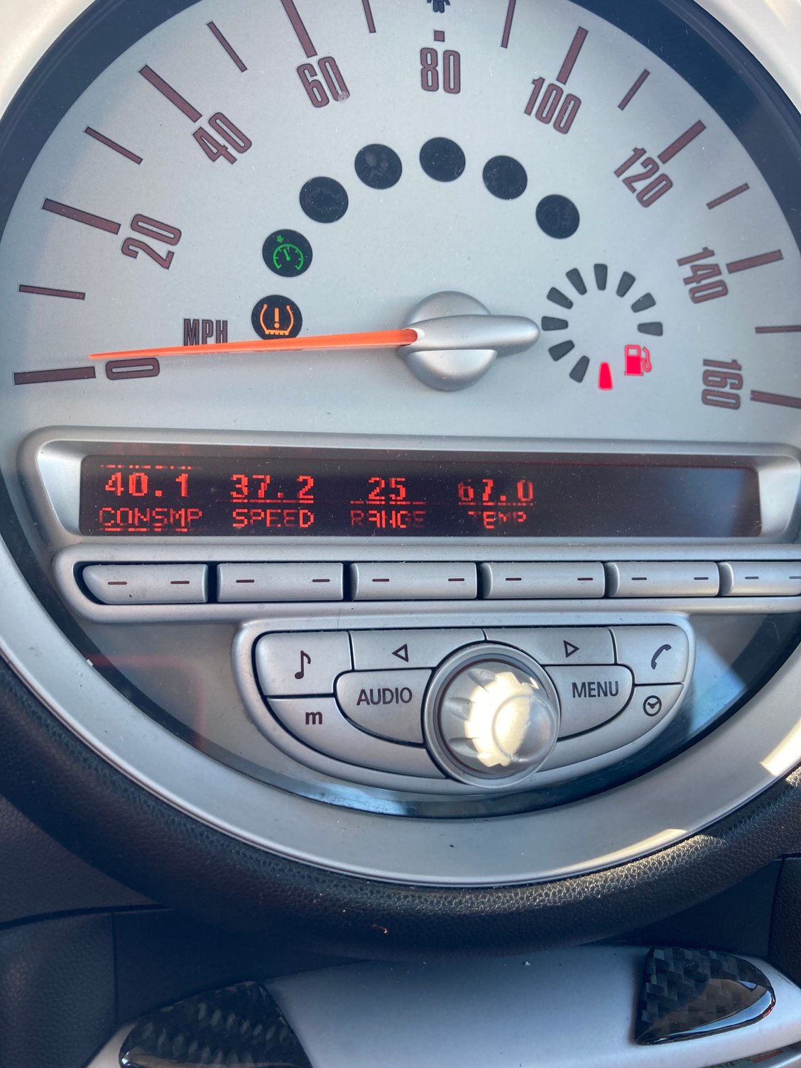

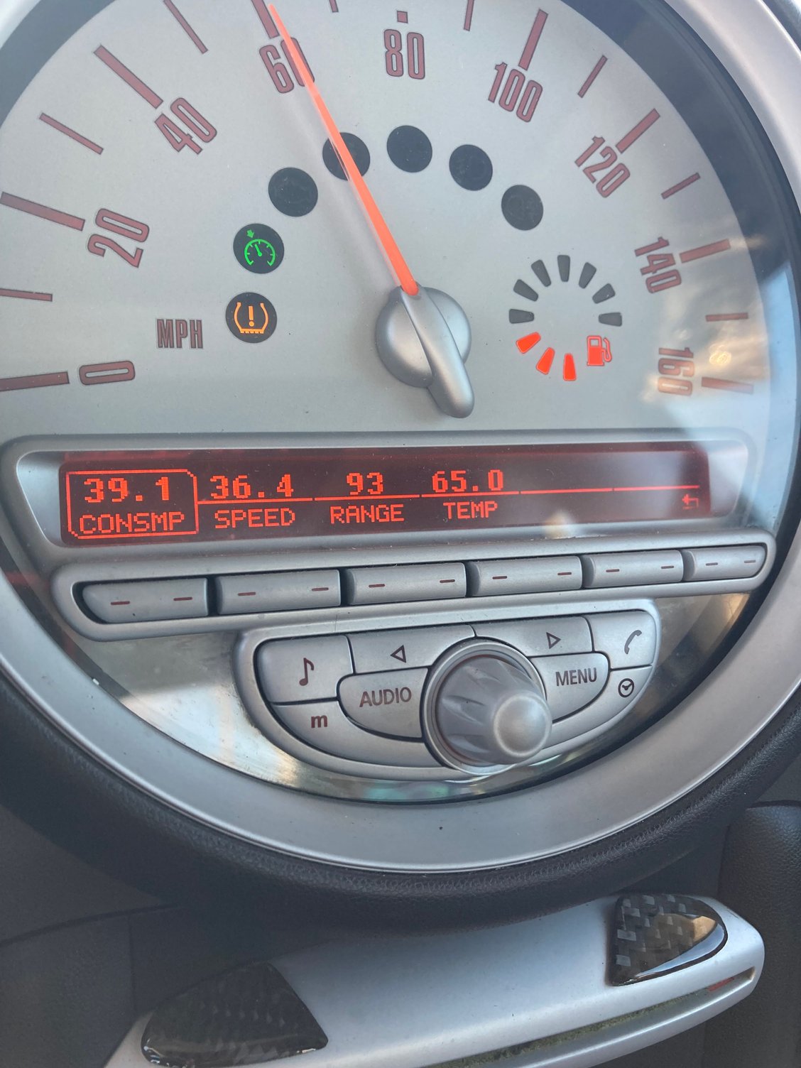

—The dash screen and dash lights get dimmer the hotter it is outside, on cold days the lights seem so vivid and bright, on hot days the screen for the clock and audio becomes half faded and looks like it’s melted and it’s harder to see what I’m looking at compared to when it’s cold and the screen is crisp, clear and bright!
