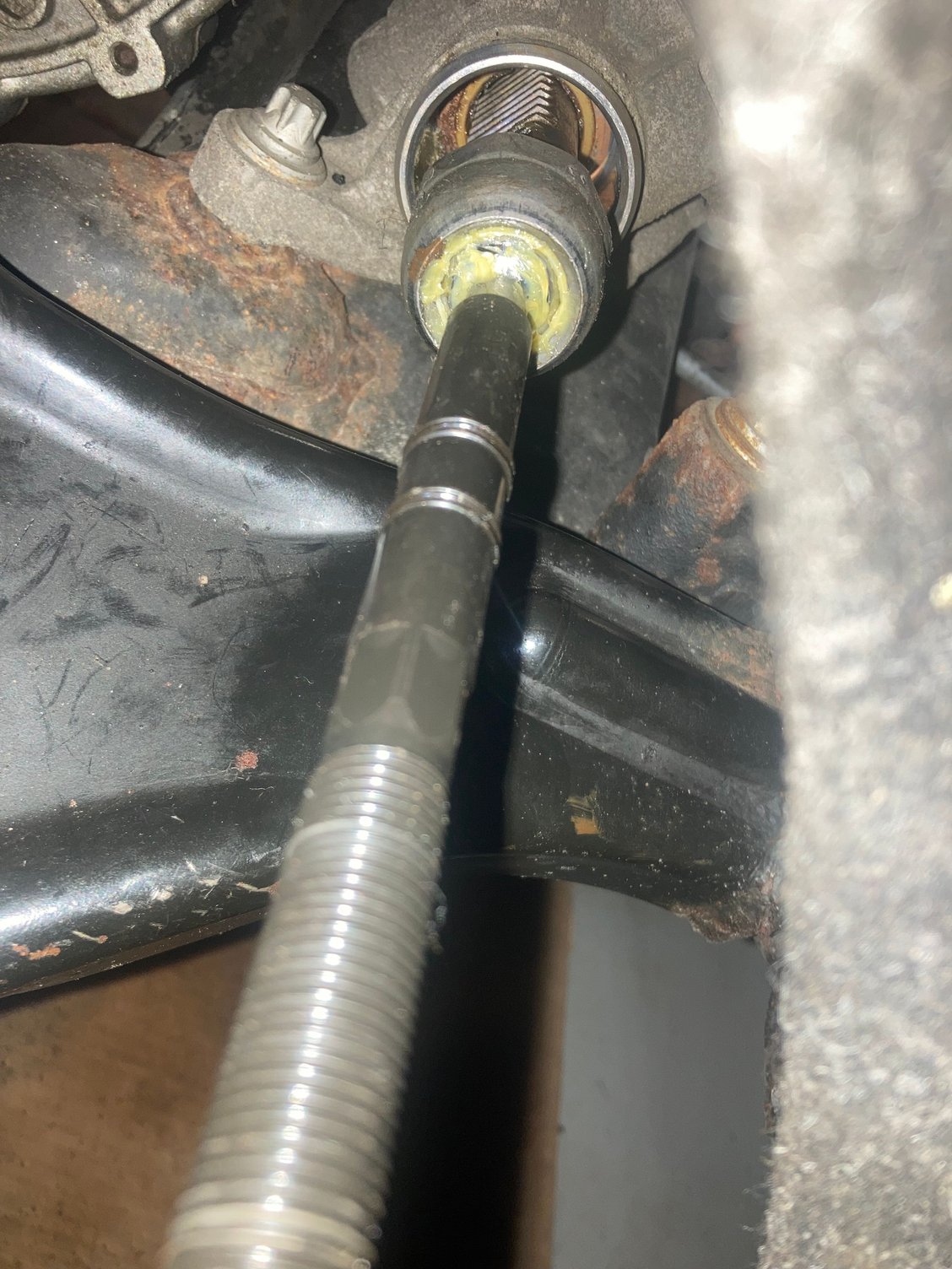

There is recommended grease for steer arm before covering how much extra grease should be added?
when the cover is fit does the SS clamp close with force applied?
if I test that I may not get on but assuming force applied around clamp?

This is the stuff officially recommended by BMW:
https://www.ecstuning.com/b-genuine-...1/83238849305/
You might be able to find something comparable.

I have the grease from ECS how much should be applied before the cover is installed?
The interior SS strap looks like should close with pressure?

You need a special tool to clamp those stainless retainers. I used zip ties, and 6 years later, they are still holding.

Thnx info just what I was looking for!

That vid from a VW seemed to miss that the rubber gaiter does not fit onto steer cover first one I got too hot trying to do in place with heat gun.
second one I heated slower whilst pulling it expanding the dimension of the bigger end to get to fit on the rack!
but was needed quite a bit of pulling & grease to get on the rack, go figure.

The rubber boot from Mini fit better did not need excessive stretching so on just warm up.
