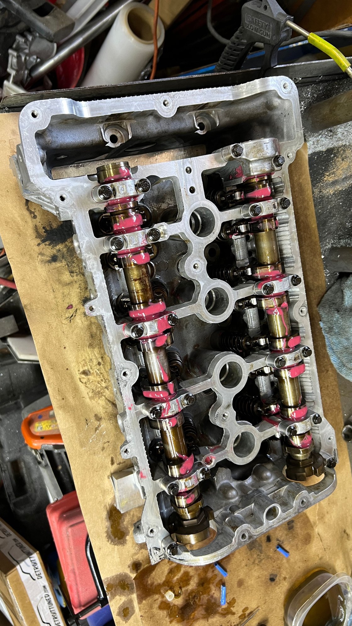

I have a 08 s to play with in my shop. Great low mile example with a crashed motor. Pulling the motor and rebuilding.
Would love to discuss some mild options for enhancing performance while I am in there. I have the head done, although i could change cams still.
What would you do to meet or exceed jcw power and keep street drivability?
thanks
John H
Head built w new valves, stock S cams.

Street and mountain driving. MAYBE a track day or two just for giggles.
Will be looking pistons and rods, probably okay but will change anyway. Will open up the exhaust.
Driveline i will replace the flywheel and clutch, and install an LSD.
