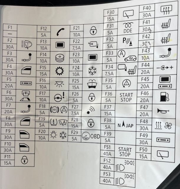

Start by checking the 4 Footwell fuses:
With the ignition key turned ON, do you measure battery voltage to body ground at both top test tabs for each of the 4 installed FRM fuses? If so, does battery voltage reach X14261 Footwell connector pins 1, 3, and 34 and X14260 Footwell connector pin 2?
RT/BL = red/blue wire
RT/SW = red/black wire
RT/VI = red/violet wire
RT/GE = red/yellow wire

Information found on the fuse box cover suggests that 30A FRM fuses F4 and F8 are dedicated to the power windows, whereas 40A FRM fuses F52 and F53 are dedicated to the lights. This means that you can focus your multimeter tests on fuse F52, fuse F53, X14260 connector pin 2, and X14261 connector pin 34.
