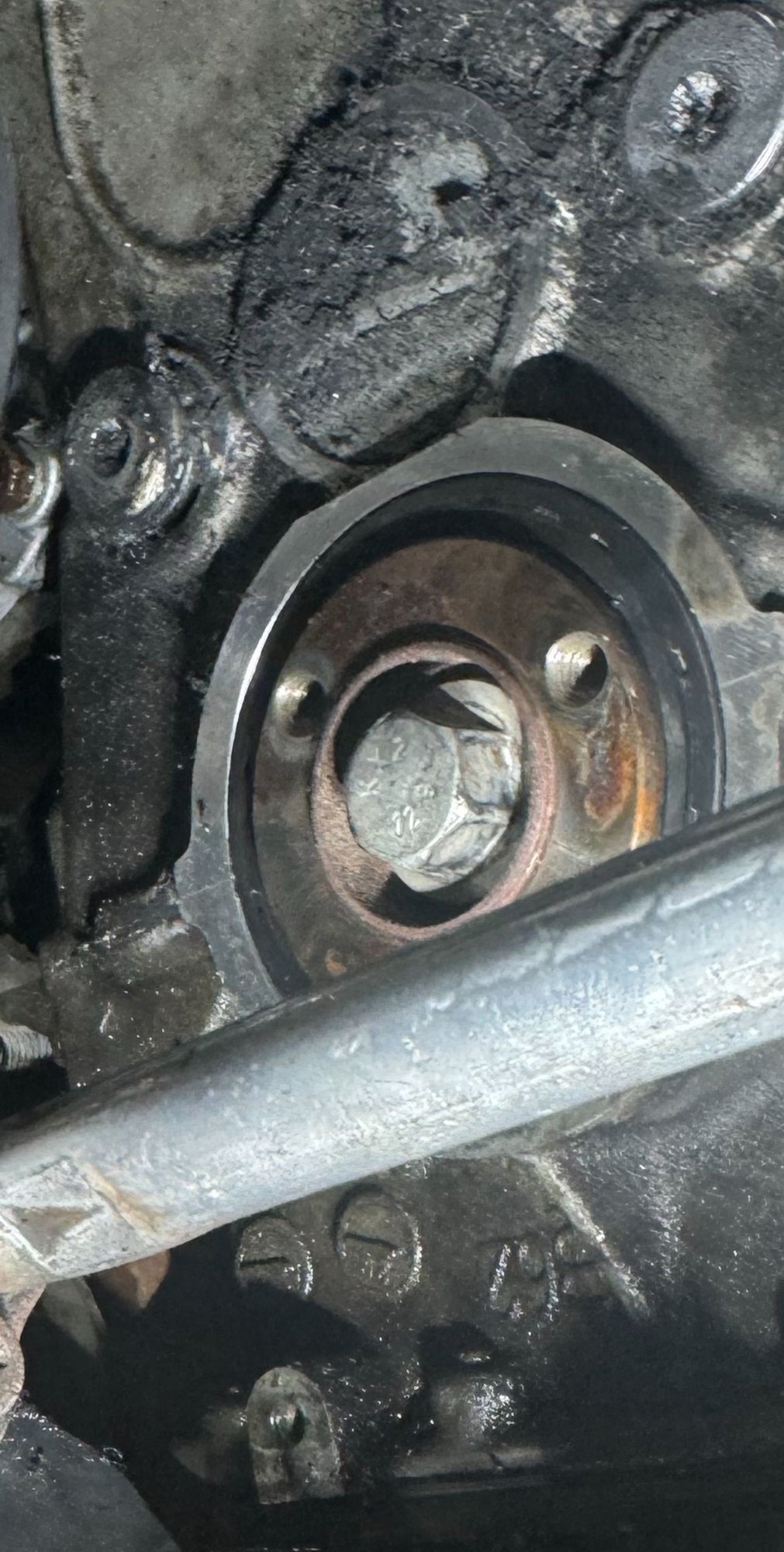

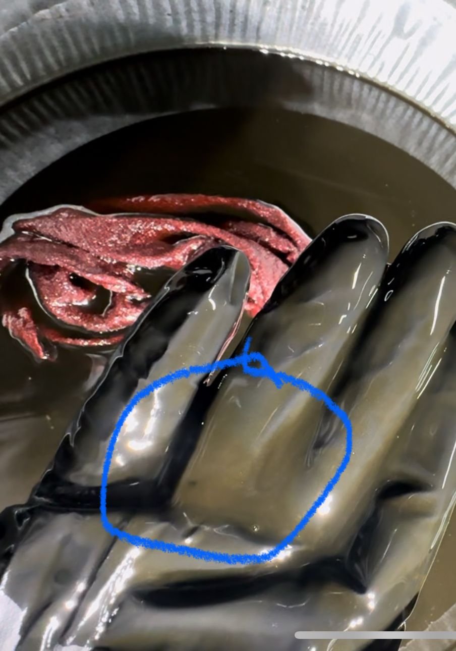

I drove 30 miles home, the car sounded like garbage, especially at idle. I ordered a new vanos solenoid and installed it. After installing new solenoid and deleting vanos adjustments car still ran like crap. So I investigated further. Turns out intake guide rod bolt was out of the block by 0.5"-0.75", it was out so far it had worn on the crank dampener, and was shredding the belt.
After calling the shop, they want to tow car back to have one of their "more senior mechanics" inspect the engine so they can "figure out how to make it right". I need some advice. In my mind this engine is now completely shot, with the amount of metal in my oil I just don't see any way this engine has not been significantly harmed. Assuming I let them inspect the engine what should I be looking for in their inspection?

Guide bolt not installed right. Main crank seal also installed wrong.
Black dot in circle is a piece of magnetic metal from oil

That's not alot of metal by any means man !!!!
I've seen r56s with far worse than that on every oil change. It's pretty typical to find that actually.
it's when you start seeing chunks like THIS you need to start to worry..
funny though , even after this amount of metal was found , the guys car is still running good and being used daily...
I wouldn't be too concerned about the metal though man. Just make sure they fix their **** up and absolutely dont pay them another dollar for ANY work they do. This is their mess up , they need to clean up.
btw , my pics dont do justice to the amount of metal in that filter, there was literally solid metal in the grooves of the filter. Lol idk how but the engine even still sounds healthy.

It is a ton when you consider this oil only went 30 miles. However, thanks for the reassurance, still waiting on a fix.
There was some chunks in oil, unfortunately I didn’t pull the filter so don’t have pictures of what that captured.
